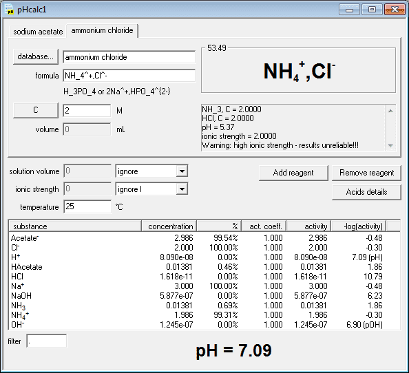

Let's say we have a 1.00 L solution containing 3 moles of NaCH3COO and 2 moles of NH4Cl.

I am afraid it is not that easy as you are trying to make it, you need much more sophisticated approach (the one that was already mentioned earlier).
BTW, by my calculations (not that I did them manually) pH of your solution should be 7.1, so almost neutral.

Borek, could you show your calculations? I'd like to see houw you got 7.1 pH. Thank you
I am afraid you won't get the details of the calculations from that: :wink:
Model used described here: http://www.chembuddy.com/?left=Buffer-Maker&right=buffer-calculation

You are right ... That is confusing, but looks very interesting. I'd like to know more about the calculator. Anyways, looking at Staralfur's calculation, I'd say it seems to be right on point. If I may, here's my analysis ... You are welcome to critique ...
