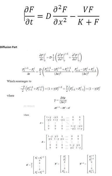

Thank you both for your response. Based on your feedback, I am doing the crank nicholson implicit technique. I can code the diffusion equation in Matlab with the Crank Nicholson scheme using backslash divide on a martix, but there is an added term to the end of my equation that I do not know how to fit it into the tridiagonal martix. See the attachment, there is a term VF/K+F added to the end of the equation (where we are solving for F). The use of a tridiagonal matrix to solve this equation requires linear operation, that is
Code:
AF(t+dt) = BF(t) +d(t)
How do I rearrange that last equation after the diffusion equation (will probably be t, not t+dt?), so the F from the denominator is now in the numerator, so I can incorporate it into the matrix? I am unsure how to solve this, it is really puzzling me. If I can understand how to set up the matrix I can code it no problem. Thanks again.
Does anyone have any idea how this V*F/K+F would be "linearized" and fit into the matrix?

Thank you for your response. I actually have been trying your second method, where j = time steps:
[itex]\frac{Vmax*F(j+1)}{KM+F(j)}[/itex]
However, I guess my question is how to actually solve the matrix. If I set up my matrix of the form
Code:
A*F(j+1) = B*F(j)
then,
[itex]F(j+1)*\frac{Vmax}{KM+F(j)}[/itex]
ends up appears on the left side of the equation, along with the rest of the F(j+1). However, it contains a F(j) term in the demonimator that becomes part of "A". Therefore, it cannot be solved in Matlab, by say the "backslash divide" technique. Am I correct? Shouldn't all the F(j+1) appear on one side and F(j) sppear on the other? I can solve the diffusion equation using crank nicholson and the backslash divide in matlab, but I am not understanding how this equation now fits into the matrix.
If someone can clearify this that would be much help, or propose a different technique.
You need to construct the tri-diagonal matrix only for the quantities on the new time step n+1. You calculate the nonlinear term using the known values on the old time step n. The nonlinear term is therefore known and stays on the right-hand side.
