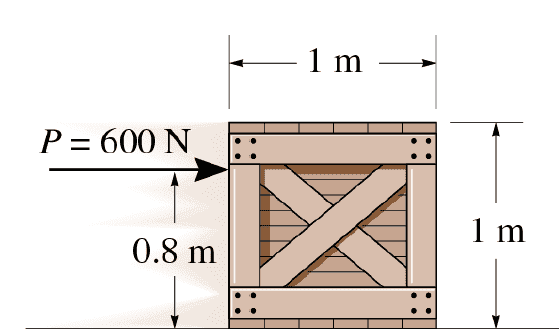

I would like to know the considerations needed to find the tipping of a box. It is given μk=0.2 and the box is 50kg
There are actually 2 ways of solving the problem:
1. To consider the moment about the centre of mass of the box, given that the normal force on the box will be redistributed.
So, considering moment about center of mass,
clockwise moment= Ff(0.5) + F(0.3)= 50(9.81)(μk)(0.5)+(600)(0.3)=229.05Nm
anticlockwise= (50)(9.81)(x) =490.5x Nm [Normal force x distance, x from the centre of mass]
For net moment about center of mass to = 0,
490.5x=229.05
∴x=0.467< 0.5 (Therefore, box won't tip because the normal force does not leave the box)
2. However, we can also consider the moment about the bottom right corner of the box, where it will potentially tip at.
In this case,
anticlockwise moment= W(0.5)= 245 Nm
clockwise moment= N(0.5-x) +600(0.8) = 496.18 Nm
∴ clockwise moment will result.
There seems to be a contradiction with the 2 methods as shown above. Could someone point out any errors or concepts that could have been missed?
If the center of mass has acceleration, then the relation ##\sum \tau = I \alpha## will hold if you take the origin to be the center of mass, as you did in your first method. But the relation does not generally hold about other points chosen as origin, as in your second method.
Suppose the crate is in free space (no gravity, friction or normal force) and the 600 N force is applied as shown
Here, the line of action of the force passes through the center of mass of the crate as the crate accelerates to the right. Consider the net torque about (1) center of mass, (2) lower right corner.
If you go to a frame of reference accelerating with the center of mass of the crate, then you can apply the principle of torques about any point if you include a "fictitious" force due to being in an accelerating reference frame.

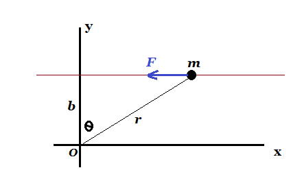

Newton's rotational law in its general form is ##\vec {\tau}_{\rm net} = \frac{d \vec L}{dt}##. This law holds in any inertial frame about any fixed point in the frame. However, I don't believe that you can generally replace ## \frac{d \vec L}{dt}## by ##I \vec{\alpha}##.
So, ##\vec {\tau}_{\rm net} = I \vec{\alpha}## is not generally true, even in an inertial frame. However, it can be shown to be true for a rigid body if the center of mass is taken as the origin: ##\vec {\tau}_{\rm net, cm} = I_{\rm cm} \vec{\alpha}##
For example, consider a single particle acted on by a constant force ##\vec F## as shown
The torque about the origin ##O## is constant: ##\vec \tau = Fb \, \hat k##. How would you define ##I## and ##\alpha## so that ##\tau = I \alpha## about the origin?

The condition for sliding is ##P \geq \mu_smg##. Sliding starts at ##P = \mu_smg##.
The condition for tipping is ##Ph\geq mg\dfrac{w}{2}## where ##h## is the height at which ##P## is applied and ##w## is the width of the box. Tipping starts at ##P = mg\dfrac{w}{2h}##.
For the box to tip before it starts sliding, the sliding threshold must be higher than the tipping threshold: $$\mu_smg > mg\frac{w}{2h}~\rightarrow~\mu_s>\frac{w}{2h}.$$Here, ##h=0.8## m and ##w=1.0## m which results in ##\mu_s>0.4##. No information about ##\mu_s## is provided, only that ##\mu_k=0.2##. If we assume that ##\mu_s=0.2## because that's all that's given, the box will slide before it tips.

Im not too sure about using this... because if we assume tipping starts at Ph = mg(w/2), for the example Ph= 480Nm clockwise and mg(w/2)=245.25 Nm anticlockwise. The moment provided by the force will always be greater... furthermore, given that the normal gradually gets redistributed and its line of action gradually shifts from the centre to the right edge... it would always be acting to reinforce the clockwise moment to tilt it...
So I think the analysis would not work...
One has to be careful what is meant by that.
If you mean the corner of the box, however that might move, then you have to allow for the fact that it accelerates, so you have a non-inertial frame.
Safe is to take the initial position of the corner as a fixed point on the ground, and include the linear acceleration of the box's mass centre, multiplied by its height, as part of the angular acceleration about the axis.
Yes, but it can tip too. Bear in mind that the applied horizontal force is given as a constant. If it slips, the force has to do correspondingly more work.
