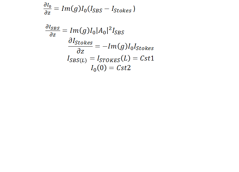

Good evening I have these coupled equations and was wondering if there is any chance solving them analytically. If not, how would you approach it numerically? (shown in attachment)
Thank you very much

Hello eahaidar,
Don't you think that is a bit terse ? Some explanation of the variables might be in order. Complex variables ? Probably: in particular: g -- if g is real nothing happens.

Thank you for your time. The variables are [/0], [/STOKES], and [/SBS]. As for g, it is a real constant number despite having many variables.
My attempt well: i only could find a relation between the 3 equations. Clearly equation 1 = 2 + 3 however other than the initial conditions of [/STOKES] and [/SBS] are available while [/0] is found at the end of the length of a waveguide L. I do not know what to do next.
Hopefully you can help me out
If ##\ g\ ## is a real number (but a function of many non-involved variables, but not ##z,\ I_0, I_{SBS} {\rm \ or \ } I_{stokes}\ ## -- correct ? ), then what does ##Im(g)## mean ?
I also have difficulty understanding your "Clearly equation 1 = 2 + 3 " since that implies ##\ \left | A_0 \right |^2 = 1 \ ##, which I haven't seen in the problem description ?
Whatever, my first approach would be a Runge-Kutta integration and use a shooting method to end up with ##Cst_1## and ##Cst_2## -- which are given constants at ##z = L## -- but then it seems you intend to go the other way with initial conditions for ##\ I_{SBS} {\rm \ and \ } I_{stokes}\ ## at ##\,z = L\,## (?) and have ##\ I_0(0) \ ## at the end of the pipe ?
Thank you for your time. g is complex and I apologize for that. However, Im(g) is a constant number since it varies with another variable other than z. So let's say Im(g)= 0.5
What I meant from 1=2 +3 is that notice that d(I0) /dz = d( ISBS)/dz + d(I STOKES)/dz.
As for your approach, I0 represents the intensity of light introduced into the medium while SBS and STOKES represent 2 light waves counter propagating the forward wave of index 0 which puts me in trouble since initally at z=0 I only have the forward wave.
With that being said, is your suggestion still valid? If not what other choice do I have?

So, if I summarize: you want to solve
$$ \begin{cases}
{dI_0\over dz} & = \ \ \ \ Im(g) I_0(I_{sbs}-I_{stokes})\\ {dI_{sbs}\over dz} &=\ \ \ \ Im(g) I_0 I_{sbs}\\ {dI_{stokes}\over dz} &= - Im(g) I_0 I_{stokes}
\end{cases}
$$ With initial condition ##\ I_0(0) = C_2,\ ## and boundary conditions ##\ I_{sbs} (L) = I_{stokes}(L) = C_1##
Since 1 = 2 + 3 ## {d\over dz}( I_0 - I_{sbs}-I_{stokes}) = 0 \Rightarrow I_0 - I_{sbs}-I_{stokes} = Const ##, an unknown constant

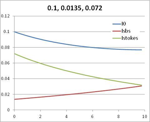

I leave out the Im(g) (It's an over-all scale factor ) and give it to an integrator with initial conditions C2, u and v, respectively. Then I fumble with u and v until both end up at ##C_1##. In the picture below ##C_2 = 0.1, \ \ C_1 = 0.0312## u and v come out 0.0135, 0.072
I did the fumbling (shooting) by hand, but you can let the computer do it.Since 1 = 2 + 3, ## \ \ {d\over dz}( I_0 - I_{sbs}-I_{stokes}) = 0 \ \ \Rightarrow \ \ I_0 - I_{sbs}-I_{stokes} = Const ##, an unknown constant, you don't really have to integrate all three (##Const = C_2 - u - v## )

Program is a dynamic simulation program for the chemical industry, called aspen custom modeler. But all I use is the integrator, so I didn't mention it. It has lousy graphics, so picture is made by moving the data to excel. Also easier to do further analysis: take logarithm, fit that to a polynomial, to see if it's a simple exponential. It is not:
(##\ \ln(I_{\rm stokes} ) = -2.6356 - 0.0939 z + 0.0011 z^2\ ## )
Got the curves by doing the forward integration from z = 0 to 10. Chose C2 = I0(0) = 0.1 and played around with ISBS(0) and Istokes(0) until they ended up at the same value. I called that C1. Normally you would let the computer do the guessing (shooting method) with a reasonable efficiency.
So still no joy finding something analytical.
