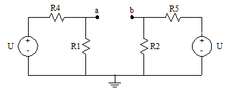

Perhaps this will hep you move forward. With R3 removed from the circuit it should be clear that you have two potential dividers providing potentials at the open terminals where R3 sat. Each potential divider is comprised of a pair of resistors and a driving voltage U. Redraw the circuit so that the two potential dividers are shown separately:
You can provide each with its own voltage source U without changing how the circuit operates, since both potential dividers are driven by a potential U to begin with and they don't interact in any way with R3 out of the picture.
Now you should be able to reduce each of the potential dividers to their Thevenin equivalents and then proceed to further simplification. In fact, you should be able to work out the overall Thevenin equivalent pretty much by inspection.

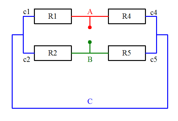

You will find gneill's suggestion explained in more detail here: http://www.hallikainen.com/rw/theory/theory6.html

R1 and R2 will not become in parallel even if you remove R3. Both ends of R1 will not be connected to R2. Only if you short circuit R3, R1 and R2 are connected in parallel, but then you change the all over circuit.

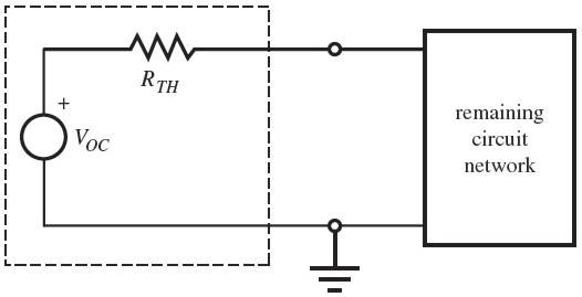

A Thevenin equivalent looks like this (dashed box).
It's an emf ( Voc ) in series with the inner resistance, Rth ( like a battery ).
So you must calculate Voc and Rth as for A and B ( separately ). Now attach R3 in between:
A---------R3---------B.

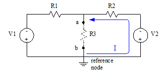

Okay guys, I think I better show you the example I have been given, so you know what knowledge I am supposed to be using while solving this problem.
http://postimg.org/image/fo6brj1kx/
http://postimg.org/image/x3wh42fk5/
http://postimg.org/image/4pdc7o4vb/
I' d say this one example is not sufficient in the least but that's what I have been given to work with.

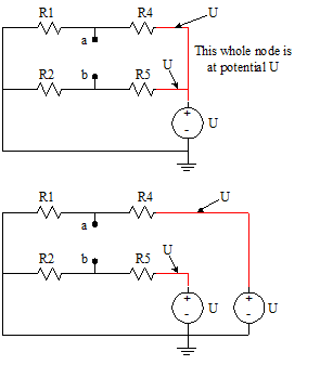

Splitting a node by duplicating the source that drives it is okay so long as it doesn't change any of the potentials in the circuit. I did it to try to make clear that there are essentially two separate voltage dividers:
The potentials driving the voltage dividers are the same after the source is duplicated. So you have one voltage divider providing the potential at terminal a, and another providing the potential at terminal b. The figure in post #4 was just a rearrangement of the the dividers on the page to highlight their independence and make it more obvious how to get at the Thevenin equivalent. And in fact you've successfully determined what the circuit would look like from the point of view of the open terminals with the sources suppressed.
Now, how might you determine the open potential across the terminals a-b?[/quote][/quote]

In the example you presented above, one of the target terminals was also the reference node, so you only had to determine the potential at one location (with respect to that reference node). The method and results were fine.
In the present case you have two terminals, neither of which is the reference node. Yet you want to find the potential difference between them. The simplest way to go about that is to determine their potentials separately with respect to a common reference, then take the difference.
You can do this in several different ways. One is to recognize that the terminals in question are each part separate voltage dividers and use the voltage divider formula. Another is to render them both into their own Thevenin equivalents, then combine those into a single Thevenin equivalent. That would get you to your overall result of both Vth and Rth in one set of steps, although you've already determined Rth so it might be extra work for little gain (except perhaps practice).
I'd suggest going the voltage divider route at this point. Work with the bottom figure in post #14. Find the potentials at a and b.

Yes, the reference node is one that you choose for convenience and is usually designated by the little triangle symbol (there are other symbols that are used occasionally, but the triangle is quite prevalent). Think of it as the spot in the circuit where you might attach the negative lead of a voltmeter and then use the other lead to measure various potentials elsewhere in the circuit: it is thus the reference point to which you refer other potentials. You are free to choose any node as a reference node, but most often a particular choice will be more convenient than others. It's largely a matter of experience to develop the insight and intuition to choose a node that will make your analysis easier.
And what I understood from what you wrote is that I need to figure out the current for each circuit and then use it to calculate the Ua and Ub ?
But maybe I got it all wrong.
No, that's a reasonable way to proceed. Find the current then use it to determine the potential drops across the resistors in order to establish the potential at the node in question (do a "KVL walk" from the reference node to the node in question, summing the potential changes along the way). The voltage (or potential) divider rule that I've mentioned several times really just combines these two steps into one operation. The situation comes up so often in circuit analysis that the resulting reduced formula has been named. There's an analogous rule for current division.
The drawings above were all I was given with almost zero explanation so if you could please explain which one was it and why, and why here it is not the case, I would be extremely grateful.
In the example you gave the reference node of choice happened to coincide with the lower connection point for the load for convenience. The reference node is always assumed to be the zero potential reference point in a circuit (unless otherwise specifically stated), so that (conveniently) gives you potential at that node without having to do any work to find it. That left only the potential at the top connection to find (where the top of R3 connects when it's in the circuit). A KVL walk from the reference node to that terminal might pass through V2 and R2 (or the other way around the loop, through V1 and R1).

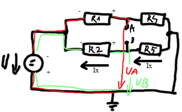

Okay I am just about to give up. Today's class was even more disappointing and we didn' t do any of these circuits so I would like to ask you if you could provide me with a step by step solution (with pictures that have arrows symbolizing the Ut and Rt I am looking for if possible, I would be very grateful for that) which I will then try to understand.
Anyways, my last attempt was this:
Calculating the current I:
After removing the R3 resistor, I am left with 2 parallel resistors R1 + R4 and R2 + R5, so I calculated the current that goes through the lower half of the circuit like this:
Ix = U/R2 + R5
Then the upper current:
Iy = U/R1 + R4
And because the I coming from U is split between the upper and lower part of the circuit, the final I would be Ix + Iy.
Calculating the Ut:
Then using the current, I would determine UR1, UR2, UR4 and UR5.
Then UA = U - UR1 and UB = U - UR2
My final Ut would then be the difference: UA - UB
Calculating the Rt:
If I supress the source, I am left with a parallel circuit and I either put together R1 + R2 and R4 + R5 or R1 + R4 and R2 + R5.
My intuition tells me the first one but I have drawn the picture earlier with the second option and you said that was correct.
So I then do Rt = R14*R25/R14 + R25 to figure out Rt.
I have tried both ways but neither gave me an answer that would match the star delta method one.
I am however very close (I am supposed to be getting something like 0.22... and I am getting 0.20...).
I' d love to hear your thoughts!

Okay. You should insert parentheses to group terms in order to fix the order of operations so that there can't be misinterpretations:
Ix = U/(R2 + R5)
Iy = U/(R1 + R4)
and that would be correct.
Do you need that total I for anything? Certainly not for the potential calculations...
Calculating the Ut:
Overall you've got the right idea. But I'm concerned about some details:
You didn't explicitly specify a reference node, so It's hard to confirm your formulas. But something looks off to me since both R1 and R2 are connected to the "-" terminal of the voltage supply U and if you took that as your starting point a KVL walk from there through U to the terminals wouldn't pass through those two resistors.
Perhaps you should take your initial circuit diagram and indicate the currents and potential drops that you're using (their polarities in particular).
Calculating the Rt:
For two components to be in parallel both of their leads must be directly connected, nothing in between. For each of the components you need to be able to trace a path via wires only from one component to the other for both of their leads. Note that drawn placement or orientation on the page does not determine series or parallel... only the topology of the circuit counts. Components can be turned, moved, or otherwise mucked about with on the diagram so long as their node connections are not altered. When in doubt, number each node in the circuit and then list each component along with their node associations. Parallel components will have the same associations.

The way I figured out the walk was that I placed the reference point all the way down there, and did two walks.
On the first one I passed UR1 and on the second one UR2. Here I drew a picture:
http://s16.postimg.org/pfvzvw21x/walk.png
Did you pencil in the potential polarities first? Your currents pass through the resistors in a certain direction, imposing a polarity. Also, the direction in which you "walk" through a source determines the sign of the potential change:
So, walking from your reference node at the bottom, through the source U and through R2 to terminal B you have:
UB = -U + UR2
You could also have taken the path to the right, passing only through R5:
UB = -UR5 = -Ix * R5

Hey there again!
Sorry, forgot to draw the polarities, they are the exact opposite of the ones you added so I guess my equations should be correct then?

Look at the following diagram. The source has been suppressed:
Clearly, R1 and R4 are connected at node A. Clearly R1 and R4 are also connected at node C. If you have done the exercise of listing the components and their node associations you know this. So R1 and R4 are connected in parallel. Call their combined resistance R14.
The same is true for R2 and R5. Both are connected to nodes B and C.
So you have two parallel connected resistor pairs. Call their resultants R14 and R25. R14 connects between A and C. R25 connects between B and C.
So what's the resistance between A and B?
I would say series because that gives me the right result! At long last!
