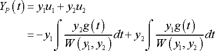

I got the formula
from http://tutorial.math.lamar.edu/Classes/DE/VariationofParameters.aspx to solve for the particular solution of the DE.
In this problem, g(t) = e^t + t, y1 = e^t and y2 = e^-t .

Then plugging in the values to the equation, I got 1/2 (t - te^-t - e^-t) for v1 (or u1 in the formula) and -1/2 (1/2 e^2t + te^t - e^t) for v2 (u2 in the formula).
Multiplying these by y1 and y2 respectively, I got these:
v1y1 = 1/2 te^t - 1/2 t - 1/2
v2y2 = 1/4 e^t - 1/2t + 1/2
