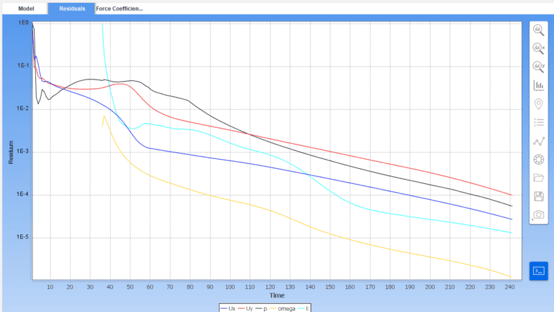

1st fig, The residuel graph, im not sure what this means or shows

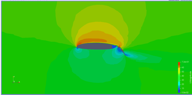

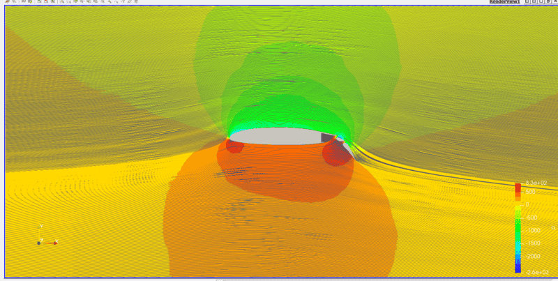

3rd and 4th, This velocity and pressure flow. High velcoity on top and low below. This indicates high pressure below and low pressure above generating lift. Increasing the velocity on top and decrease below would iMaxiumizing and mininzing the pressure producing improved lift.

eg what are the residuals and what is it showing?

1st fig:
you are basically solving the system of equations Ax=b (A a matrix, x,b vectors) for the unknown x, which is the vector containing the solution of all variables, so pressure,velocity, etc at all points in the domain. During the iterations, you update your current estimate of the solution x. If you have the exact solution x, then Ax-b=0. As long as you do not have the exact solution, then Ax-b = R, with R a nonzero 'residual' vector. The residual plot shows for all variables the residual value. These residual values should be very low, 1e-4 is usually on the high side.
2nd fig:
During the iterations, you can compute values of lift, drag etc. It is not clear exactly what is shown in the figure, but you can see that the values seem to converge to a certain value. You can also see that they are still changing a little, so 240 iterations is not sufficient.

Fig.1 (residual graph) it solving various residuals, residuals being various properity of the object under study (pressure on the wing, velocity of the wing). It is done in iteractions. each iteraction it gets closer to zero, with zero being exact solution for the equation. as it gets closer to zero accuracy increases. high residual low accuracy, low residual high accuracy of the solutions. Solutions being the condions on the wing (pressure velocity and so on).

fig.3 (velocity map), this shows the velocity and quantity over the wing and the pressure.
fig.4 (streamlines), this shows only the directions of the pressure flow.
for fig.4 why is it red underneath and not on top like in fig.3 like they flipped.
Yes, that's about right. I guess with iteractions you mean iterations? You can see the residuals as a measure for the error. For figure 2, the results do not need to be high, the lift and drag need to go to a value that does not change anymore with increasing iterations. This is an indication that you have reached your final solution.
in Fig 3,4, the red regions just indicate regions where the value is high. Velocity is high above the wing, pressure is high below the wing. If you follow a streamline, then Bernoulli's law tells you that when the velocity over a streamline increases, pressure decreases.
