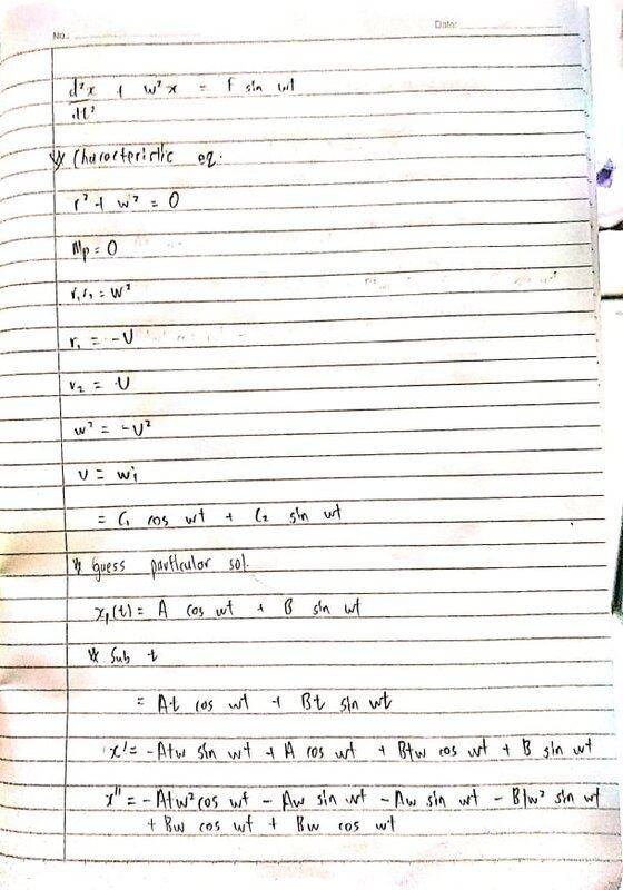

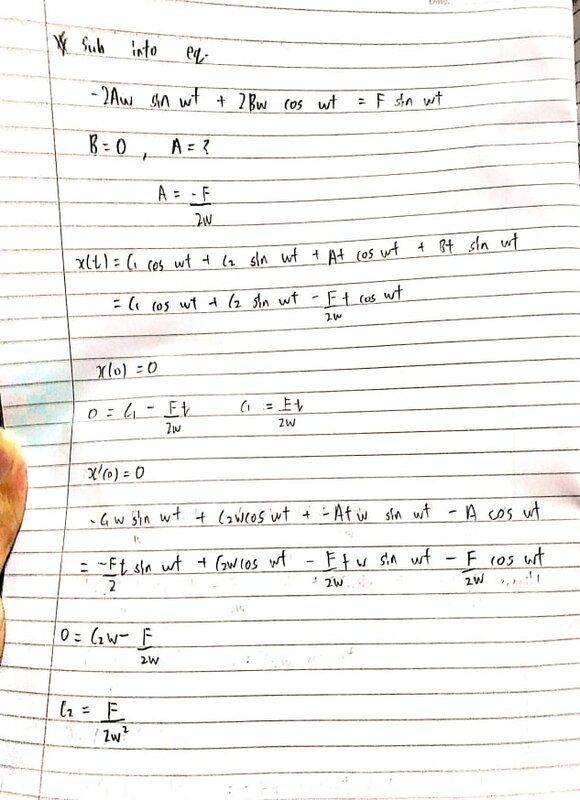

So fat this is what I got.
Your work looks OK to me, but you wrote ##x_p = A\cos(\omega t) + B\sin(\omega t)##. That's a solution to the homogeneous problem (i.e., ##x'' + \omega^2x = 0##, not a particular solution to the nonhomogeneous problem. The work following that seems fine, though.
You've done the hard work -- all you have to do is check that your general solution 1) satisfies the two initial conditions, and 2) satisfies the given differential equation.
You solved for ##C_1## incorrectly.
OK thank you all, I will correct my mistakes.
