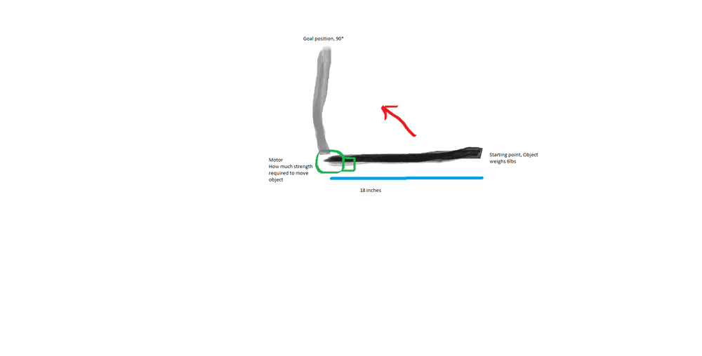

I want to know how to solve: What is the power or torque required to lift an 18 inch long object, that is 6-8 pounds, from an anchored end.
I am at my wits end with trying to find this formula. So far all I've gotten is I need to figure out mechanical power, maybe torque? I can't figure out the formula for this motion as it is like negative leverage. I want to build a machine that can do this thousands of times so I also need to figure the longevity of the motor's power required. My degree is in hospitality management, and the only math or physics classes I could really push my limits in is finance. I am trying to learn, and am starting to hit a wall. If anyone has any idea where I can look to find this information I would greatly appreciate it. 18 inches(7lbs) from flat position to 90 degrees vertical, and back down softly.

In its initial position, the arm exerts a torque about the axis. Can you calculate that? That is the torque your motor needs to exceed in order to lift the arm. Once it starts to rise the required torque will decrease, so the arm will accelerate. You may need some way to ease off the motor to avoid coming to a violent stop at the top.

Thanks @haruspex! I have been trying to find the formula to calculate reqd torque with the length of the object causing greater resistance at first. I believe I will be able to program torque speed by rotation, but I am not sure how to get the first part

Draw a force diagram for the arm. Where does its weight act? How far is that from the axis? So what is the torque the weight exerts about the axis?

The worst condition is the horizontal position, as explained above.
That torque equals the weight times half the length of the door.

You may have run across the term "Center of Mass" (CM), also called "Center-of-Gravity" (COG). That is the point in an object where its Mass (or weight) can assumed to be concentrated so that calculations are easier. If that horizontal thing you want to rotate has uniform weight along its length, then the CM is in the center. For your 18" object, that puts the CM at 9" from the pivot.
So for an 8 pound mass at 9" from the pivot, the torque needed to support it would be 8 x 9 = 72lb.in. Note that this is the torque to support it; if you want to get it moving you will need a little bit more torque to overcome the inertia.
Now to address the torque variation over the rotation angle:
Obviously the torque will be maximum at the horizontal position. Just multiply that 72in.lb by Cos(α), where α is the angle from horizontal. For instance at 30° elevation Cos(30) = 0.866. So multiply 72 x 0.866 = 62.4lb.in.
Additional torque is needed to get it moving, or to slow it down at the top of travel. How much additional depends on what acceleration is desired, i.e. how quickly you what it to reach a given speed. That I'll leave to others here who know that stuff by heart, I would have to look it it up, somewhere! :oldwink:
