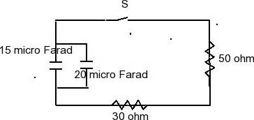

I have an RC circuit with two capacitors connected in parallel. Both capacitors are initially charged to 45.0 V.
a.) How long after closing the switch S will the potential across each capacitor be reduced to 10.0V?
Knowns:
C1= 15.0 microFarads
C2= 20.0 microFarads
R1= 30.0 ohms
R2= 50.0 ohms
Here is a diagram. http://www.chegg.com/homework-help/questions-and-answers/circuit-shown-figure-capacitors-areinitially-charged-450--long-closing-switch-s-potential--q201797
v=q/c
q=Q(initial)e^(-t/RC)[/B]
I know that both capacitors have the same potential difference because they are connected in parallel.
I have used v=q/c to find the charge q of the first capacitor when the potential v is 10 V.
q=vc
=10V*(15*10^-6F)
=1.5*10^-4C
Next, I found the initial charge of the first capacitor.Q(initial)
Q(initial)=45V*(15*10^-6F)
=6.75*10^-4C
Lastly, I foundthe time at which the potential of the first capacitor is 10V which corresponds to the charge q at that time.
q=Q(initial)*e^(-t/RC)
solving for time t=-RC*ln(q/Q(initial))
My answer comes out as 1.8 milliseconds but the correct answer is 4.21 milliseconds. Is there something wrong in my understanding of the problem? What is going on here?
