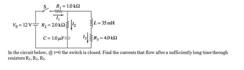

RLC equations:
q= Qmax e ^ -Rt/2L cos wd t
wd = [ 1/LC - (R/2L)^2] ^ 1/2
So, I am trying using Kirchoff law, but not sure what the question asks.
I thought it may be a trick and after a long long time C will be fully charged and L will act as a simple wire, so it will be a simple circuit with Resistors.
I canot see the image attached.
Yes, the phrase "after a sufficiently long time" is a typical hint used in problems to refer to the eventual steady state conditions. Suppress the reactive components as you suggest and analyze the resulting resistor network.

Im in doubt should i remove the C and keep it as a RL circuit or both of them. Sorry my bad. I will add them properly
Open (remove) the C and short the L.
