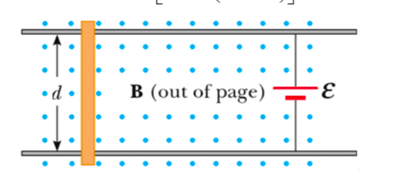

A bar of mass m, length d, and resistance R slides without friction in a horizontal plane, moving on parallel rails as shown below. A battery that maintains a constant emf ε is connected between the rails, and a constant external magnetic field B is directed perpendicular to the plane of the page. Assuming the bar starts from rest and that the field produced by the rails is very small compared to the constant external magnetic field, show that at time t it moves with what speed
Shown below
242527
Above is the figure of the problem.
I am trying to solve x(t) and differentiate it to obtain v(t); however, I have difficulty solving the differential equation shown below.
$$ v(t)=\int a(t)dt=\int \frac{B(\varepsilon-Blv)d}{Rm}dt \Rightarrow \frac{dx}{dt}=\frac{B\varepsilon d}{Rm}t-\frac{Bld}{Rm}x $$

If you are trying to find the speed, why not solve for that directly?
What is ##l##? Is that the same as ##d##?
Likes christang_1023
##l## is the same as ##d##.
Not solving for v directly was because I consider that ## v(t)=v_0-\int a(t)dt,## which contains ##\int vdt=x##; therefore, I wanted to solve the ODE for x first, which is shown above.
Fortunately, thanks to your hint, I manage to solve v directly based on Newton's 2nd law:
$$ F=m \frac{dv}{dt} \Rightarrow \frac{B\varepsilon d-B^2d^2v}{mR}=\frac{dv}{dt} $$

What does your answer look like if ##B## is small? Does it make sense?
The result is $$ v(t)=\frac{\varepsilon}{Bd} (1-e^{-\frac{B^2d}{mR}t}) $$
According to L'Hospital's Rule, ## \lim_{B \to 0} v(t)=0,## that is to say when B is sufficiently small, the bar won't move at all, and the whole circuit remains still. It is reasonable.
