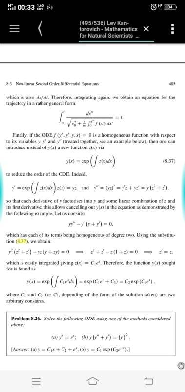

I tried the substitution ##y=e^{\int z(x)}##,##z(x)## is an arbitrary function to be determined.
Substitute this to the original differential equation,and dividing ##y^2## yields ##(z+1)z'+z^3+z^2+z=0##,which is a first order differential equation.
Trying to solve this first order differential equation yields ##x= ln z -\frac { ln (z^2+z+1)}{2} +\frac {\arctan( {\frac {2z+1}{\sqrt{3}}})}{{\sqrt{3}}}##
Then I can't continue here.The expression seems implicit and I cannot get an expression of ##z## in terms of ##x##,that can be substituted back to ##y=e^{\int z(x)}##.Had I use the wrong substitution or any better subsitutions?

By the way,I tried this substitution from this :

Well,I also doubt that there exist any methods to produce such an expression as shown.
According to Wolfram Alpha ,I think actually the main part of the solution consist of the inverse function of the implicit expression above.Maybe my thought still has a little bit of use...
