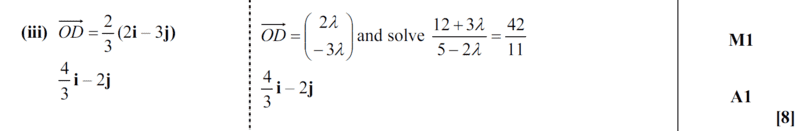

This is an international past paper question- I have attached the question and the markscheme... the ms was a bit confusing for 2 marks hence my post.
vectors.
Question; interest is on part iii. only
Mark scheme solution;
My thinking;
Let
##OD=λOA## Where ##λ## is a scalar.

We end up with the simultaneous equation;
##2λ+11κ=5##
##-3λ+42κ=12##
##39λ=26##
##λ=\dfrac{2}{3}##
therefore,
##OD=\dfrac{2}{3}
\begin{pmatrix}
2 & \\
-3 & \\
\end{pmatrix}=\dfrac{4}{3} i -2j
Unless, there is something i have overlooked on the ms... the question ought to have been given more marks...cheers
Your insight highly appreciated.
The mark scheme seems pretty consistent in awarding one mark for choosing a correct method and one mark for getting the correct answer using that method. So part (i) is worth two marks: one for observing that \vec{AB} = \vec{OB} - \vec{OA} and one for doing the subtraction. Part (ii) is worth 4 marks: 2 for finding \vec{OC} and 2 for calculating its length. Part (iii) is worth 2 marks: one for stating a condition which ensures that \vec{DC} and \vec{OB} are parallel, and one for using that condition to find \vec{OD}.
For part (iii), the mark scheme gives two methods to find \vec{OD}, each of which get the same number of marks:
  • If \vec{DC} and \vec{OB} are parallel, then OAB and DAC are similar triangles. We know \vec{AC} = \frac13 \vec{AB}, so \vec{AD} = \frac13\vec{AO} and hence \vec{OD} = \frac23 \vec{OA}. (This is the most obvious method if you've drawn a diagram.)
  • If vectors are parallel then the ratios of the \mathbf{i} and \mathbf{j} components are equal; we know that \vec{DC} = (5 - 2\lambda)\mathbf{i} + (12 + 3\lambda)\mathbf{j} for some \lambda and we know \vec{OB}.
So whatever method you use to determine \vec{OD}, and yours involves more steps than both of these, you get one method mark and one answer mark.
