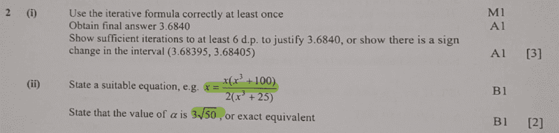

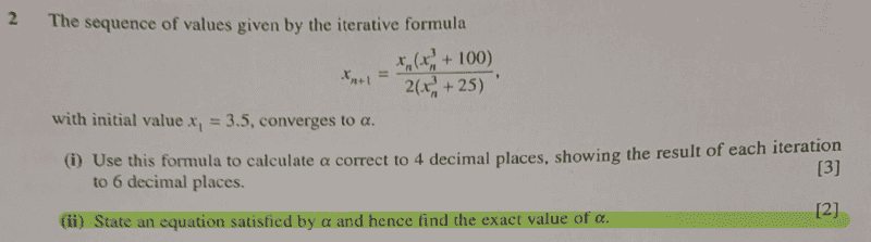

I need insight on ##Q.2 (ii)## part only,
find mark scheme here;
How do we determine suitable equation, ##x=x...##?
ok, just looking at the solution, we shall have;
##2x^3+50 = x^3+100##
##x^3=50##
→##x##=##\sqrt[3]50##≡##3.68403## which is the value of ##α## ( convergent value as indicated in previous step).
I think it was an error to indicate ##3\sqrt 50## ...am assuming it was a typo error which is a bit misleading...been cracking my head trying to figure out on this.:cool:

From the recurrence relation, you can write this:
$$x = \frac{x^4 + 100x}{2x^3 + 50} \Rightarrow 2x^4 + 50 x = x^4 + 100x$$
IOW, all I did was replace ##x_n## and ##x_{n + 1}## by x.
The latter equation simplifies to ##x(x^3 - 50) = 0##, so x = 0 or ##x = \sqrt[3]{50}##
Yes, it was a typo in the problem statement. They wrote ##3\sqrt{50}## when they should have written ##\sqrt[3]{50}##; i.e., the cube root of 50, not ##3 * \sqrt{50}##.
Nice Mark, but you also realize that we could divide both sides of the equation by ##x##... to realize the required solution...
##x=0## in this case would not apply.
It's almost never a good idea to divide both sides of an equation by the variable. x = 0 is a solution of the equation ##2x^4 + 50x = x^4 + 100x##, and is in fact a solution of the iterative formula ##x_{n+1} = \frac{x_n}2 \cdot \frac{x_n^3 + 100}{x_n^3 + 25}##

Ok cheers Mark...agreed in that case, we may say that the mark scheme was not conclusive on the possibilities of ##x##. They ought to have given provision for two solutions, then indicate that solution ##x=0## is "unsuitable".
