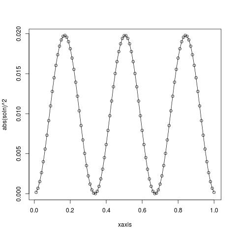

Here's an R-Code that forms the Hamiltonian matrix for the discretized square well problem and solves the eigenstate n=3 (the ground state is n=1), plotting the probability density as an output:
Code:
L <- 1                                               # Length of the domain
N <- 100                            # Number of discrete points
dx <- L/N
A = matrix(nrow = N, ncol = N)                # Hamiltonian matrix
n_state <- 3                        # Number of the eigenstate to be calculated
for(m in c(1:N))                    # Fill the Hamiltonian matrix with elements appropriate for an infinite square well problem
for(n in c(1:N))
A[m,n]=0
if(m == n) A[m,n] = 2/dx^2
if(m == n-1 || m == n+1) A[m,n]=-1/dx^2
v = eigen(A)                       # Solve the eigensystem
vec = v$vectors
soln = c(1:N)
xaxis = c(1:N)*L/N
for(m in c(1:N))
soln[m] = vec[m,n_state]               # Fill the vector "soln" with the wavefunction values
jpeg(file = "plot.jpg")                   # Plot the probability density
plot(xaxis,abs(soln)^2)
lines(xaxis,abs(soln)^2)
dev.off()
The plot that this code produces looks just like you'd expect from a square of a sine function.
