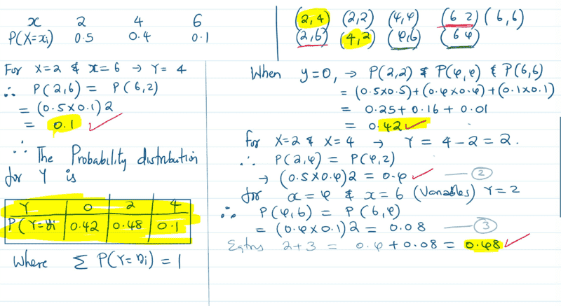

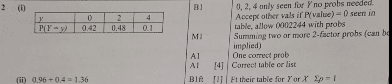

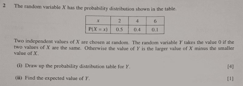

This is the problem;

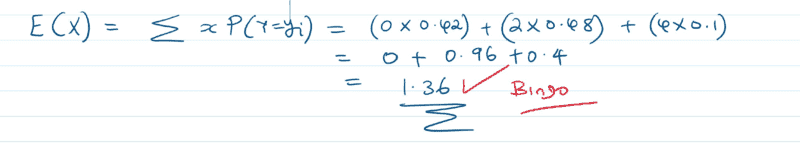

Find my working to solution below;
find mark scheme solution below;
I seek any other approach ( shorter way of doing it) will be appreciated...
chwala said:
Homework Statement:: See attached
Relevant Equations:: understanding of probability distribution concept...
It would have been quicker to have found the probability of Y=2 by subtracting the other two probabilities from 1. I don't see any other shortcuts.
That's true, but it could pose problem to a student who may have made a mistake on say finding wrong values of ##Y=0 ##& ##Y=4##, ...if you get what I mean... this error would consequently affect the value of ##Y=2##.
Finding the values of ##Y## indepedently and then checking whether their total sum is ##1## is more concrete...
