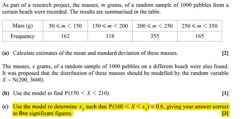

My interest is on part (c),
My take,
##Z=\dfrac{160−200}{60}=−0.666666##
##Pr(−0.66666)=0.3546##
##⇒\dfrac{x_1-200}{60}=1.05##
##x_1=63+200=263##
Yes, i am aware that they want the answer to ##5## significant figures...i just wanted to check the alternative method...
Appreciate your insight...
What do you mean with the probability of -2/3? The density of the distribution there?

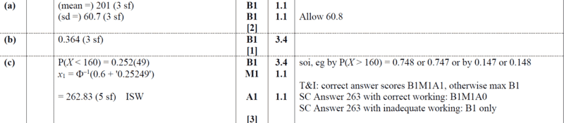

One approach is to calculate P(X > 160). Your work should include the probabilities that some random variable is greater than or less than some number. Pr(-.66666) is meaningless as a probability, a pointed hinted at by the previous poster.
To get you started, calculate Pr(X > 160) = Pr(##\frac{X - 160}{60} > \frac{160 - 200}{60}##) = Pr(Z > -0.66667)##. That should give you a number that is larger than 0.6. You should then be able to find the Z score (and hence the X value) that gives you the correct probability, using a table of z-scores.

My point was that when ##z =-0.66666## Then the area subtended between the two x points would be equal to ##0.3546##
Yes I meant the density...I shouldn't have used term probability...I hope that makes sense...otherwise, I need to check again...and I should have used inequalities instead of equal sign...Will amend that later.

Then that is incorrect since Pr(Z = -0.66666) = 0. For a continuous probability, any probability statement should involve a random variable in an inequality.

Yes, in my approach i first found the area bound by ##160## and ##X.## I found that to be; ##0.2454## then i took ##0.6-0.2454=0.3542## ...

I made a mistake ...find the corrected version here;
My take,
##Pr(−0.66666)=0.2454##
##0.3542= Z_{1.05}## Therefore
##x_1=63+200=263##
