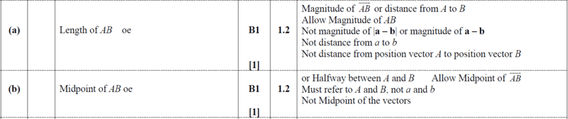

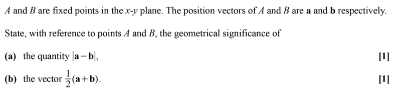

My interest is on part ##a## only. Is the markscheme correct?
I have ##BA= -b+a= a-b.## It therefore follows that ##|a-b|## is the Length of ##BA##...or are we saying it does not matter even if we have ... ##AB.## Cheers
and for part (b), going with ms
##AB=b-a.## Let the midpoint of ##AB=M##, then ##⇒AM=\dfrac{1}{2}(b-a)## unless i am missing something, there seems to be something wrong with the guide response...

##|AB| = |BA|##.

The textbook is correct. Try some example vectors to see where are ##\frac 12 (\mathbf b + \mathbf a)## and ##\frac 12 (\mathbf b - \mathbf a)##
Likes chwala and Delta2
It is ##AM=\frac{1}{2}|\mathbf{b}-\mathbf{a}|## (notice we take the magnitude of b-a)
however (b) asks for the vector ##\frac{1}{2}(\mathbf{a}+\mathbf{b})##. The full detailed response should be that this vector is equal to the position vector of M.

Thanks, let me look at this again...
