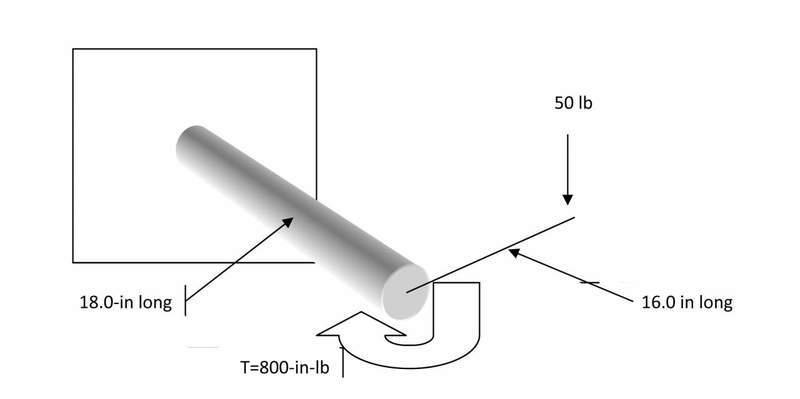

hey everyone I am stuck on a problem and would appreciate any guidance you could give me.
here is the question:
Much as in exercise 8.1, the end of a .75-in-diameter rod is fixed to an immovable plate. the length of the rod is 18.0-in. A 50-lb weight is attached to a 16.0-in lever at the opposite end of the rod so the weight is hanging perpendicular to the longitudinal axis of the rod.
Reference problem 8.1 is this:
The end of a .75-in-diameter rod is fixed to an immovable plate as shown. The length of the rod is 18.0 in. A 50-lb weight is attached to a 16.0-in lever at the opposite end of the rod so that the weight is hanging perpendicular to the longitudinal axis of the rod, For steel, E=29,000,000 lb/in² and μ=.303. The poplar moment of inertia for a solid circular shaft may be found by J=πD⁴/32, where D is the shaft diameter.
A. Determine the minimum diameter ro so that the maximum torsional stress does not exceed 8,000 lb/in². (I have solved this problem)

B. Determine the minimum diameter rod so that the maximum torsional stress does not exceed 8,000 lb/in². (this is the one I am stuck on)
I think I need G which I used E/2(1+μ) = 29,000,000 lb/in² / 2(1 +.303) = 11,128,165.77 lb/in²
please note π is meant to represent pi
From what I understand you have a shaft, and attached to its free end is an eccentric load of 50lb.
So what you have is a case of both bending and torsion.
You can replace the 50lb acting at the 16in by a single 50lb acting at the free end of the shaft+ a torque of (50*16)lb*in.
So you know that
shear stress τ =16T/πD³
Now you just need to get bending stress using σbend=My/I.
Then combine using the principle stress equation and the shear stress theory.
attached is a diagram.
It looks like I miss typed my problem for 'B' it should read this.
Determine the minimum diameter rod so that torsional strain does not exceed 1.00 degrees.
Sorry about that. for some reason a and b were the same. I solved a already but am stuck on B

You should know the equation
T/J = τ/r = Gθ/L
But in your first part, you did not account for th bending.
Due to the load being at the distance of 16 inches, you will have both bending and torsion happening. You only accounted for a case of only torsion.

For the first part, the eccentric loading, will cause bending + torsion.
For the second part, the torsion alone will produce the rotation, which you do not want to exceed 1 degree.
In all cases, your torque is T=50lb*16in = 800 lb-in.
For the second one:
You have T/J = τ/r = Gθ/L
you found 'G' and you have 'L' and you want θ=1° = ___ radians.
so you want T/J = Gθ/L and you have J=πD4/32, so you can find 'D'.
For the first one: You showed that τ=16T/πD3. This stress occurring due to torsion.
Due to bending you will have σ=My/I
y=D/2 and you can get I in terms of 'D'.
The 50lb load will be acting at a distance of 18in, so you can get M.
Do you know the principle stress equation?

Right so J= 0.0741415291 in4 and you know that J= πD4/32. So you can get 'D'.

You have J=πD4/32 which means that D4 = 32J/π
θ=TL / JG, J = TL/Gθ = 800 in-lb * 18 in / .0741415291 in * 11,128165.77 lb/ in² =
.0174532925 rad, 1 rad = 57.30° = .0174532925 * 57.30 = 1.0°so it checks out
J = πD⁴ / 32, 32J = πD⁴ = 32(.071415291 in) = 2.285289312 in.
D⁴ = 2.285289312 in / π = .7274301808 in, D⁴ = .7274301808, .7274301808) ^(.25) or ∜(.7274301808) = .9235232405 in
Check ---- J = πD⁴ / 32 = π(.9235232405 in⁴ / 32 = .0741415291 in so that checks out also
Thus my diameter D=.9235232405 in
