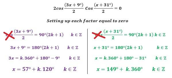

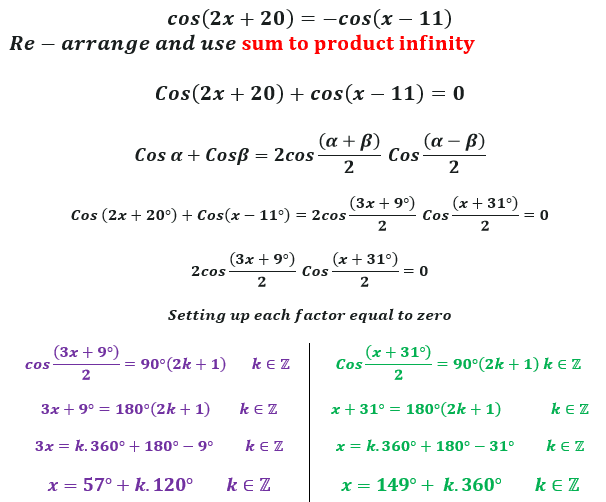

Thanks a million skeeter. Much appreciated!
I have attached complete work out based on your guidiance.

small correction ...
Thank you very much! Much appreciated!
