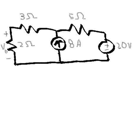

Use the superposition theorem to find Vo in the circuit
i made 8A source 0 so the first equation using KVL becomes:
10i1 = -20
i1 = -2
then making the 20V source 0, the next KVL equation becomes:
i think it's 5i2-8 = 0
i2 = 8/5
i think I'm messing up the second equation with the 20V source as 0...
