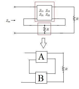

I am having some issues with this problem I am doing. I will show what I have done so far and where I am getting confused.
1. Homework Statement
The 2-port shown in Figure 2 is characterized by its Z-parameters, where ##Z_{11}=Z_{12}=Z_{21}=Z_{22}=R##. Find the input impedance ##Z_{in}##. Express your result in terms of ##R## only. Hint: The input impedance of a 2-port terminated with load impedance ##Z_L## is ##Z_{in}=Z_{11}-\frac{Z_{12}Z_{21}}{Z_{22}+Z_L}##
[tex]V_1=Z_{11}I_1+Z_{12}I_2[/tex]
[tex]V_1=Z_{21}I_1+Z_{22}I_2[/tex]
So the first thing I notice is that this is two 2-port networks in series which is then terminated by a load resistor ##R## on the RHS. The top one I will call ##A##, and the bottom one I will call ##B##. Therefore the Z matrix is simply the sum of the two matrices from each 2-port network.
[tex]Z=\left( \begin{array}{c,c} R+Z^B_{11} & R+Z^B_{12} \\ R+Z^B_{21} & R+Z^B_{22} \end{array} \right)[/tex]
If I find this matrix, I can easily plug in the values to find ##Z_{in}##. So first I would like to find the first element in the matrix. I can do this by setting ##I_2=0##. In order to do this, the right hand side must be turned into an open circuit. Using the first equation in section 2 above gives me,
[tex]Z_{11}^B=\frac{V_1}{I_1}-R[/tex]
This is where I am not sure. So I need to determine the term ##\frac{V_1}{I_1}##, which I know is just equal to the resistance across the terminals for ##V_1##. So if I follow the circuit starting from the top left, it goes through the first 2-port, and then through the second 2-port. Is the contribution from the first 2-port just ##Z_{11}^A##? If so, then ##\frac{V_1}{I_1}=R+R## meaning ##Z_{11}^B=R## which makes perfect sense.
Likewise, the same can be done for ##Z_{22}## and I get ##Z_{22}^B=R##.
I am confused about ##Z_{21}## and ##Z_{12}##. In general, I do not know what these terms mean physically which makes it hard for me to know what to do mathematically. If I can get these two terms then I can solve the problem. I know that..
[tex]Z_{21}^B=\frac{V_2}{I_1}-R[/tex]
and
[tex]Z_{12}^B=\frac{V_1}{I_2}-R[/tex]
But I do not know where to go from here.

Okay so in order to get an expression for ##Z^B_{21}## I choose to let ##I_2=0##. To do this, the circuit must be open at the output of the two 2-port networks. I then get (as before)
So now I need to find ##V_2##. This is where I am having confusion but I believe I may be on the right track.
Since this is a series connection of two 2-port networks, we have ##V_2=V_2^A+V_2^B##. ##V_2^A## is the voltage across the two terminals on the RHS of 2-port A and ##V_2^B## is the voltage across the two terminals on the RHS of 2-port B. Both of these I believe are simply ##I_1 R## because the top voltage ##V_2^A## is the voltage across both terminals on the RHS, which corresponds to ##Z_{22}^A=R##, and the bottom voltage ##V_2^B## is simply the voltage across the resistor ##R##. This gives me the following.
[tex]V_2=V_2^A+V_2^B=I_1R+I_1R=2I_1R[/tex]
[tex]Z_{21}=\frac{V_2}{I_1}-R=\frac{2I_1R}{I_1}-R=R[/tex]
In the same manner, ##Z_{12}## would also be equal to ##R##.
Thus, the Z matrix for the resistor is equal to ##R## for each element in the matrix, same as the first and the total Z matrix is simply 2R for each element. Which means this problem is nothing more than 2 resistors in series (very cool!).
So now for the load resistor. I think the hint may be there so I can use what I have found and simply plug it in as follows.
[tex]Z_{11}=Z_{12}=Z_{21}=Z_{22}=2R[/tex]
[tex]Z_{in}=2R-\frac{(2R)(2R)}{2R+2R}=2R-\frac{4R^2}{4R}=2R-R=R[/tex]
I am not sure if this makes sense though.

I'm having a rough time redrawing the circuit as two 2-port networks. Could you draw something up showing that configuration?
Otherwise I suggest looking again at my post # 3. It was really pretty straightforward.
This is how I drew it. Excuse the crudeness.
This configuration looks identical to what is in the book for a series of 2-port networks. I will go through it again to double check my work.
OK, I think that looks good. I suggest:
1. combine your two 2-port Z networks into one; then
2. use the hint for a loaded Z network.
I did it that way & got the same answer as before, halleluia!

Ha! Well I must be doing something wrong then. It was my understanding that I did indeed combine the two networks into one. The Z matrix for each 2-port each have all elements equal to ##R##. So that would mean the combined Z matrix would have all elements equal to ##2R## would it not? When plugging into the equation for the hint I get R as I have shown. What am I doing wrong?? :(
You have the right combined Z matrix. Could you show your math step-by-step?
Oh! I plugged in the wrong value for ##Z_L##! I did it again and got ##(2/3)R##.
Bingo!
