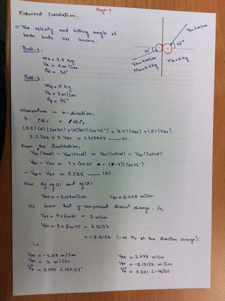

Hallo !
I am working on a problem.
The data of the problem is:
Two bodies are coming towards each other:
Body 1:
Mass = 3.5 Kg
Body 2:
Mass = 5 Kg
The velocity of body-2 before hitting was 3m/sec and angle was 45 degree.
The velocity of body-2 after hitting is 3.26197 m/sec and the angle is -40.565 degree.
I have to calculate the hitting velocity and angle of the Body-1.
By the conversation of momentum in the x-direction I have calculated the x-component of the body-1 before and after the hitting.
I am unable to calculate the y-component of the Body-1 before and after the collision.
I have get one equation that :
V_body1_y_component (before collision) = V_body1_y_component (after collision)
But I am not getting numerical value for the y-component of the body-1.
Can anybody help me ?
Thanks in advance
Regards,
Zeeshan
