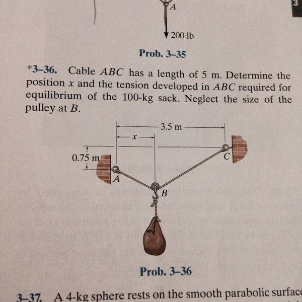

I attached a picture of the question.
∑Fx=0
∑Fy=0
100kg(9.8)= 981 N
I am not sure how to start this problem. Everything else in this chapter is a breeze so perhaps a small insight or how to start would be sufficient, thanks.

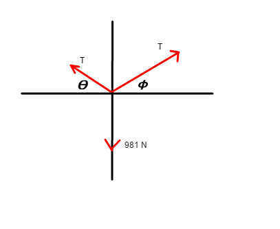

Start by drawing a free body diagram and labeling the forces acting on the sack.
So far so good.
You are given the total length of the rope ABC and some other dimensions to help you figure out the angles.
You also know that this system is in static equilibrium, so you should start writing the equations of statics for this system.
