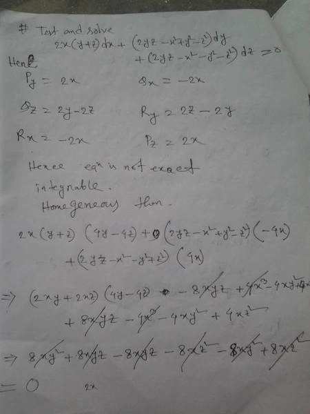

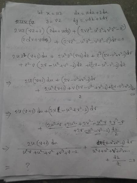

test intelligibility and solve 2x(y+z)dx+(2yz-x2 +y2-z2)dy+(2yz-x2 -y2-z2)=0
I think the word you want is "exactness", not "intelligibility".Md. Abde Mannaf said:Homework Statement
Judging by the workings which you included, you have a typo in your statement of the problem. It's missing dz .Md. Abde Mannaf said:Homework Statement
