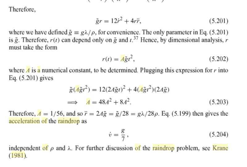

See picture below
Dimensional analysis
Solving DE
The top most 2nd order non-linear DE is the one that has to be solved. Below is the solution. This problem is from Morin's Classical Mechanics.
May I know how he could guess that r = Agt^2?
Firstly, why must g tilda be a variable within r? I do not understand what he meant by 'parameter'.
Secondly, how was it deduced that A must be a constant with no units? Aren't there many constants with units?
Thanks for all your help.

Have you read up on dimensional analysis?
The notion is that for dimensional consistency any equation can be written as some functional combination of dimensionless terms.
In the present case we believe there is an equation relating ##\tilde g, t, r##, and no other variables of dimension. So it can only involve those variables in dimensionless combinations.
Writing square brackets to mean "dimension of":
##[\tilde g]=LT^{-2}##
##[t]=T##
##[r]=L##
How can these be combined to eliminate the dimensions? Only as ##\frac{\tilde g t^2}r##. So we can write ##A=\frac{\tilde g t^2}r##, where A is dimensionless.
