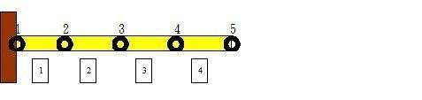

hi~I'm Rex.I have a problem,can anyone help me slove it.
The problem is : Draw the mode shapes and get the natural frequencies of the cantilever beam(with a force in free end)
The bar is shown in Fig.1(you can see in )
and it elastic modulus of 200GPa, cross-sectional area of 0.001m^2, and density of 7860 kg/m^3. P=P0*sinΩ*t applied at point xi,wherei=1,2,3,4,5(five nodes) and respectively(P0=100 ,Ω=30 and t=10(s), t is time,P is force). the problem by commercial code such as matlab. I have a MATLAB code(Euler–Bernoulli beam),This is the MATLAB code(Euler-Bernoulli beam). http://www.mathworks.com/matlabcent...of-the-cantilever-beam-with-a-force-in-free-e You can see it there,and try to run in matlab.how can i modify it and transform to Cantilever beam with end load. If you interested this question,we can discuss it. My english is poor,i hope you understand the question which i asked.Nice to meet you.

First off, your English isn't bad at all. I understood everything you were saying. I don't, however, understand the purpose of the 1,2,3,4 in boxes at the bottom of the diagram. I know the 1,2,3,4,5 at the top are for the nodes. I tried clicking on the link you provided and it said the link is no longer valid. Hopefully you can find the current link and then I'll be able to look at the code.
If you wanted to approximate the cantilever beam as a mass-spring-damper system and get the natural frequencies of the system, here is a link that will help:

The purpose of the 1,2,3,4 in boxes at the bottom of the diagram is element.So the bar is with four elements(five nodes).We can try to put the force in this nodes,like in free end point(the fifth node).

Okay, I see what you mean now. Can I see your code or the code you want to modify?
this code is in Euler-Bernoulli beam. how to modify it and transform to a cantilever beam with a force in the fifth node(free end point).
