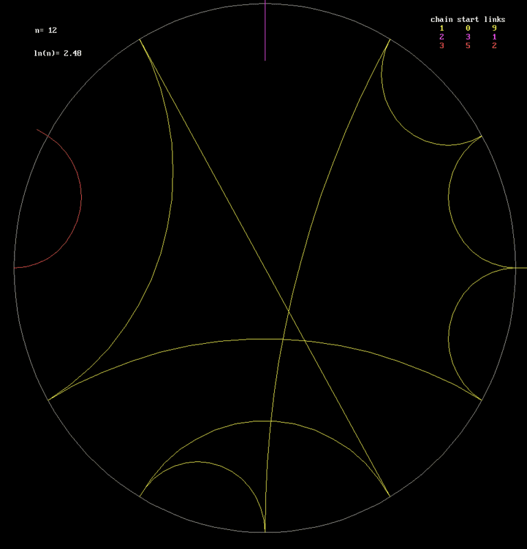

The interesting thing about n shuffled links is that there will probably be Ln( n ) loops.
Each loop saves one swap, which suggests statistically; n – Ln( n ) swaps will be needed.
Consider an array indexed from 0 to 11.
Initialise each element with it's index, so it points to itself.
Shuffle the contents of the array.
Then start at 0, and follow the links along the chain until it returns to 0.
Then select the lowest untouched, and follow that new chain until it must also close.
Repeat until all elements have been identified as members of a chain.
A link that points to itself is resolved.
If a chain contains two elements, then a single swap will resolve two tiles.
If a chain contains three elements, then two swaps resolve three tiles. Etc.
Now think of the array as a chain locker that begins with a single loop of n links.
Randomly select two links and swap them. If the links are in the same loop, the loop is split into two smaller loops. If the links are in different loops, those two loops are fused into one. Continue the shuffling process.
Shuffling by random swaps will result most often in Ln( n ) loops.
The chance that there will be only one loop is 1 / n
The chance that there will be n loops is 1 / n!
Here is a random example for n = 12.

pbuk said:
@Balancore's picture demonstrates this clearly: each arc (except for the degenerate arc at 12 o'clock) must be traversed exactly once in order to complete the puzzle; it doesn't matter where you start traversing each arc, or even whether you complete each chain before starting another one (as long as you resume the previous chain in the same place).
My intuition tells me this is entirely academic. Any tile that is not in the correct place can become the head of a chain - whether it is a half-solved chain or a new unsolved chain (since they're closed loops).
So it does not help the solver to solve the puzzle. Just be sure you are always moving unsolved tiles. Which is the obvious tactic anyway.
  • #31
So it does not help the solver to solve the puzzle. Just be sure you are always moving at least one unsolved tile into the correct place. Which is the obvious tactic anyway.
I agree (with my highlighted amendment). Chains don't help you solve the puzzle, they just prove the minimum number of swaps you need.
Likes DaveC426913
