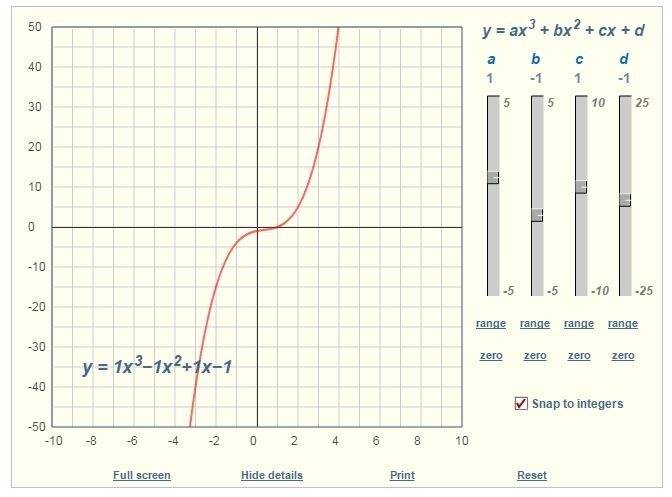

Solve by inspection means to draw the graph of this equation and check where it intersects the x axis??
Shown in the attachment. the solution is 1 if i am not wrong

By inspection means just that: look at the terms of the equation and substitute some guesses which can be evaluated using mental arithmetic.
For the equation in the OP, looking at how the signs of the terms alternate, guessing that z = 1 is a solution is a solid hunch, since the magnitudes of z, z2, and z3 are all 1.
