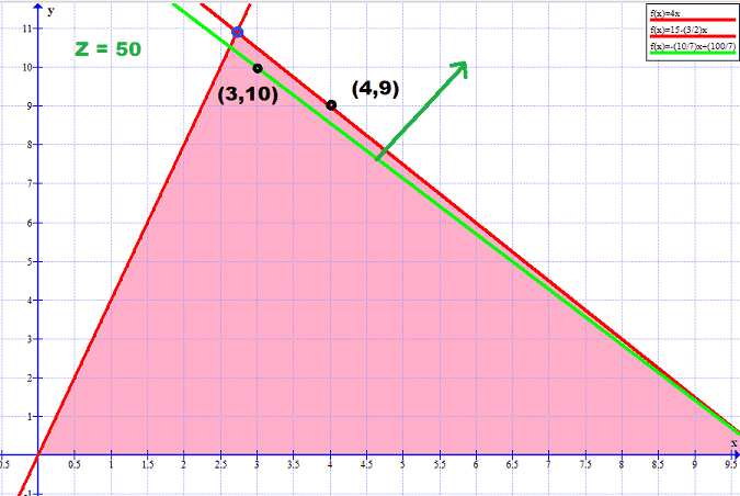

Hello,
In grade 11 of high school, I encountered this linear programming problem on my textbook:
Every six months, a decorative plants seller order Aglanonemas (A) and Sansevierias (S) to an agent, which respectively give profit of $500 and $350. The agent requires that plant A must be ordered by minimum of 20% from total plant orders. However, the seller have garden which is only sufficient for 10 As and 15 Ss. Assumed that all plants are sold out and the profit is maximized. How many As and Ss should be ordered?
The "alternative solution" described in the textbook as follows:
Let:
- ##x## : amount of plant A
- ##y## : amount of plant S
- ##L## : garden area
- ##L_x## : area of garden for one plant A
- ##L_y## : area of garden for one plant B
Since the plant order requirement is 20% of total orders are for plant A, we write: $$x \geq \frac 1 5 \left( x + y \right) \text{or } 4x - y \geq 0$$
However, the garden capacity is only for 10 A plants and 15 S plants, that is $$ x \cdot (\frac 1 {10} L) + y \cdot (\frac 1 {15} L \leq L) \text{ or } 3x + 2y \leq 30$$
The objective function is ##Z = 5x + 3.5y## (in the order of $100).
The complete linear problem equations are:

Solving the problem (using graphical method), the solutions are: ##B(2\frac 8 {11}, 10\frac {10} {11})## with ##Z = 51.818182 \text{ or } Z = $5181.8182##. However, the correct solution requires positive integers, because the solution is about amount of goods (plants), which can't be fractional. How can I solve this problem, and would it become integer programming problem? The correct solution is 3 A plants and 10 S plants, with $5000 optimum value.

The integer values define a lattice and we can apply algorithms which operate only on this lattice. This isn't an easy subject.
In a case as above where the target function behaves smooth and locally monotone (increasing or decreasing), i.e. there are no sudden jumps, singularities or other weird behaviour, we can solve the problem with continuous variables and simply test all values of the target function at the surrounding lattice points.
Likes nuuskur and FactChecker

(4,9) satisfies 4(4) - 9 = 7 > 0 and 3(4) + 2(9) = 30, and you've swapped a y for an x thus increasing Z by 1.5.

As @pasmith pointed out, x=4, y=9 gives a better feasible solution. So the book answer is not the best. This is a good example of the difficulty with integer programming problems. If there are a few more variables (and in real applications, there are sometimes hundreds), it gets very difficult to find the optimal solution. Integer programming is a large and fascinating subject. For now, you probably should just accept the book's approach and see what is next.
A drawing always helps:
The blue dot is the continuous optimum, the black ones near are feasible lattice points.
And although ##(3,10)## is closer to the continuous optimum, which is always at a vertex, there is still room left to optimize ##Z## in the direction of the arrow, because ##(4,9)## is feasible, too.
If we add the restriction, that ##Z## has to be an integer value, too, then ##(3,10)## is the solution.
