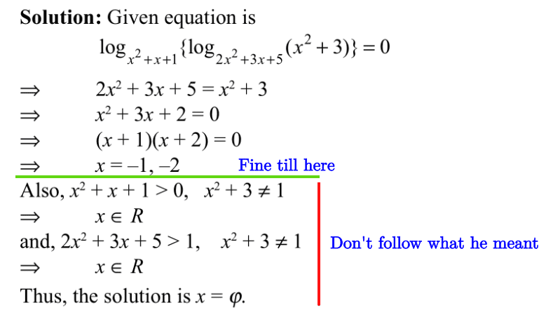

Solve for ##x## : ##\boldsymbol{\log_{x^2+x+1}\{\log_{2x^2+3x+5}(x^2+3)\}=0}##

Issue : The author says no answer for ##x## satisfies the logarithmic equation, giving ##x=\varnothing##. I copy and paste his solution below :
Doubt : Is the author mistaken? Am I? A hint would be most welcome.
Your answer looks fine to me. If x = -1, the outer log is base-1, which we can't have.
If x = -2, we have this:
##\log_{x^2 + x + 1}[\log_{2x^2 + 3x + 5}(x^2 + 3)] = \log_3[\log_7(7)] = \log_3(1) = 0##
I don't following the author's work at all, particularly where he writes ##x \in R## a couple of times, and then concludes that the solution set is empty.
Thank you. Yes I checked my answer too. Matches the conditions. Sorry about the text.
