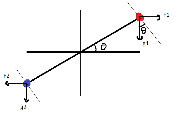

We have two charged balls of masses ##m_1=m_2##, and charges ##+q_1=-q_2##, fixed to the ends of a very light rod of length ##\ell##.
The center of the rod is mounted on a friction-free pivot, and the whole system is then immersed in a uniform electric field of magnitude ##E##.
a) Determine the period of oscillation if the system is disturbed from its initial orientation by a small angle ##\theta##.
b) What if ##m_1<m_2##?
$$\vec F=q\vec E$$
a) This looks somewhat like a pendulum problem (length ##\ell/2##).
I reasoned there will be a clockwise rotation, and that the acceleration is due to the force of magnitude$$F=-\left[(F_2\sin\theta-m_2g\cos\theta)+(F_1\sin\theta+m_1g\cos\theta)\right]=-(|q_2|+q_1)E\sin\theta=-2qE\sin\theta=ma$$
The way I thought of it is that the acceleration put to bring 2 up is added to the acceleration put to bring 1 down to make the rotation acceleration.
For small angles, I get this differential equation$$\ddot\theta=-\frac{4qE}{m\ell}\theta$$
and if I put ##\theta=A\cos(\omega t+\phi)##, then I would get ##\omega^2=\frac{4qE}{m\ell}##, and, from it, ##T=\pi\sqrt\frac{m\ell}{qE}##.
b) If I use the same reasoning, then I get an exponential solution to my problem, since the force of gravity won't disappear, which makes me think that my solution for a) is wrong.
Any help would be great!

I don't think you are meant to account for an external gravitational field (for instance, the diagram could be a birds-eye view of the configuration).

I am quite sure that you are intended to ignore gravity. After all, you are not told whether the arrangement is horizontal with you looking down from above or vertical with you looking in from the side.

But in any case, I don't think this is correct. You didn't include a contribution from the normal force from the hinge in the net component of force in the ##-\hat{\theta}## direction. With that included, ##a## would be the component of acceleration of the centre of mass of the system in the ##-\hat{\theta}## direction. But without knowing anything about ##\vec{N}##, I don't think that's useful.
It's easier to just use ##\sum \tau_z = I_z \ddot{\theta}## about the hinge.

Thank you @etotheipi and @jbriggs444! Though I think that I am to account for gravity as the problem is, originally, about a macroscopic model of a "dipolar molecule". In the first part of the problem, ##E=450## N/C, ##m_1=m_2=0.015## kg, and ##q=0.8## micro coulombs.
I will use the the relation mentioned by @etotheipi.
$$\tau_1=-\frac{\ell}{2}m_1g\sin\left(\theta+\frac{\pi}{2}\right)-\frac{\ell}{2}qE\sin\theta$$$$\tau_2=\frac{\ell}{2}m_2g\sin\left(\frac{\pi}{2}-\theta\right)-\frac{\ell}{2}qE\sin\theta$$$$\frac{\ell}{2}g\left(m_2\sin\left(\frac{\pi}{2}-\theta\right)-m_1\sin\left(\theta+\frac{\pi}{2}\right)\right)-\ell qE\sin\theta=(m_1+m_2)\frac{\ell^2}{4}\ddot\theta$$
The solution to this does give an oscillation period when the masses are equal, but elsewise it is an exponential function.
Oh, maybe in the second case I should disregard the electric field contribution? For b), I am given ##m_2=2m_1##, which gives me ##\frac{gm}{2qE}=204.375##.

Okay, nope, that's not it. When ##m_1=m_2##, the HW system accepted the answer, but rejected it for the other case.

for part a) (equal masses, so the gravity term vanishes), solving$$\frac{\ell}{2}g\left(m_2-m_1\right)-\ell qE\theta=(m_1+m_2)\frac{\ell^2}{4}\ddot\theta$$gives me ##T=\pi\sqrt{\frac{(m_1+m_2)\ell}{qE}}##.
If I suppose that I am looking from above at the system, such that gravity plays no role in the rotation, then the solution is the same, and I only need to plug new values for the masses.
If, however, I suppose that gravity does intervene in this system, then I can put ##f(t)=\frac{\ell}{2}g\left(m_2-m_1\right)-\ell qE\theta(t)##, which will eventually give me the same ##T=\pi\sqrt{\frac{(m_1+m_2)\ell}{qE}}##. o_O
So in part (b) you used ##T=\pi\sqrt{\dfrac{(m_1+m_2)\ell}{qE}}=\pi\sqrt{\dfrac{3m_1\ell}{qE}}## and that answer was rejected?

2. might be it, @kuruman.
$$m_1=15.0\,g\text{, }m_2=30.0\,g\text{, }\ell=\frac{15.0}{100}\,m$$
$$x_{cm}=\frac{15\times\frac{15}{100}}{15+30}=\frac{5}{100}=\frac{\ell}{3}$$$$\tau_1=-\frac{10}{100}m_1g\sin\left(\theta+\frac{\pi}{2}\right)-\frac{10}{100}qE\sin\theta$$$$\tau_2=\frac{5}{100}m_2g\sin\left(\frac{\pi}{2}-\theta\right)-\frac{5}{100}qE\sin\theta$$$$\frac{\ell}{3}g\left(m_2-2m_1\right)\cos\theta-\ell qE\sin\theta=\left[m_1\left(\frac{2\ell}{3}\right)^2+m_2\left(\frac{\ell}{3}\right)^2\right]\ddot\theta$$$$\implies-\ell qE\theta=\left[m_1\left(\frac{2\ell}{3}\right)^2+m_2\left(\frac{\ell}{3}\right)^2\right]\ddot\theta$$$$\implies-\frac{9qE}{(4m_1+m_2)\ell}\theta=\ddot\theta$$$$T=\frac23\pi\sqrt{\frac{(4m_1+m_2)\ell}{qE}}$$
What do you think? I only have one attempt left.. don't want to make silly mistakes. o_O
Looks fine, that's what I got. Try it and see if it works. If not, you will have to consider plan C. In any case, I am curious to know how this turns out.

It did! Thank you very much!
