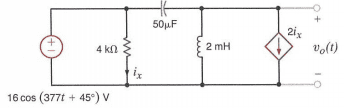

In summary, the question requests that I solve the circuit below for v0(t). I'm solving for the voltage over the inductor. I'm getting a result that's close to what I expect, however I think the phase angle of the voltage is slightly off (some friends of mine said they all got 46°, whereas I am consistantly getting 45.02°). My equations: ix=(16∠45°)/(R)=(16∠45°)/(4E3) = 4E-3∠45°KVL of second loop:0=0.754j(i1+8E-3∠45°)+4E3(4
Evales
54
The question requests that I solve the circuit below for v0(t). I'm solving for the voltage over the inductor. I'm getting a result that's close to what I expect, however I think the phase angle of the voltage is slightly off (some friends of mine said they all got 46°, whereas I am consistantly getting 45.02°).
My equations:
KVL of second loop:
0=0.754j(i1+8E-3∠45°)+4E3(4E-3∠45°)-53.05j(i1)
i1=0.306∠-44.98°
v0=0.754j(0.306∠-44.98°) = 0.231∠45.02°
v0(t)= 0.231cos(377t+45.02°)V
Image of the circuit:
EC203 assignment? ahah i got 46.59 degrees as the final angle, don't use KVL, you know at the 4k resistor the voltage is 16<45, all you need to do is apply a KCL at node v0(t) and just solve. your final answer is very close to mine, try my method and I'm sure your answer will be the same as your friends :)
Sorry i just realized you can use your method, you made one mistake, the current through the inductor is i1-2ix
Thanks, I knew one day I would bump into someone doing the same course as me! I'm not sure why I added the currents rather than subtracting them. Weird, and I've redone this one like 3 times haha.
haha :) My final answer was 2.30<46.59 volts, i don't think a little difference would matter much :) how did you go on the rest of the assignment?
but... I'm pretty sure my answer is off a bit, the angle should be 46.59 - 180... due to it being in the 3rd quadrant.. so my angle would be -133.41... what was your final answer?
*i made a few mistakes in the comments aha.
How can you tell the answer is in the third quadrant? I'm redoing the question now, I'll edit this comment as I complete it.
EDIT: I now get an even more incorrect result: 0.231∠44.98°
Redoing the same calculations on my calculator now gives: 0.231∠45°. *facepalm.jpg*
i re did mine and got 0.231<-133.4 degrees or something around their,
your answer is rectangle form should be -0.158 - j0.167. because both terms are negative it lies in the third quadrant, so you have to subtract Pi radians or 180 degrees, and that is the answer,
I think I might just grab my previous answer and run with it/ switch it to the third quadrant, rather than going over this question again and again.
