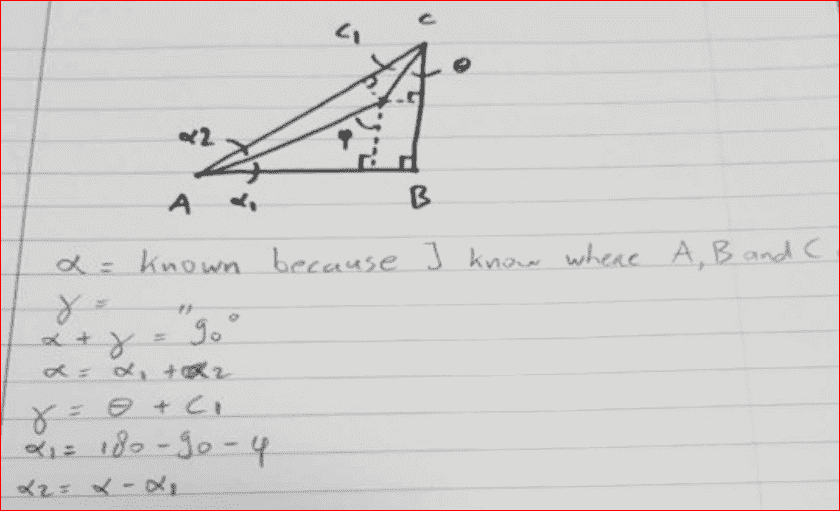

I need to solve a system of two equations for T and θ algebraic and with all the other parameters known.
φ is equal to:
The relevant equations are the two equations left of * in the image below
I tried Gauss elimination but I could not solve it further.
Now my question is if it is even possible to solve this algebraic to find T and θ.

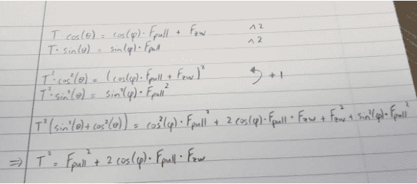

You have a system of two equations and two unknowns. It should be solvable. Write
##T\cos\theta=F_{pull}\cos\phi-F_w##
##T\sin\theta=F_{pull}\sin\phi##
Square both sides of each equation and add them. This eliminates ##\theta##. Solve for ##T##. Then divide the bottom equation by the top to eliminate ##T##. Find ##\tan\theta## and hence ##\theta##.

Then I get this:
And φ still contains θ in it

If you draw the three vectors tail-to-tip, they'll form a triangle. You can use the law of sines and cosines to try find an expression for ##\theta##.
Jeroen Staps said:
The problem is that I keep getting a inverse cosine inside a cosine or a sine and when I get this there is no possibility to get θ out of the inverse cosine right?
I think that in order to get more help, you need to give more detail regarding the overall problem you are solving. That may take this from being mainly a problem with algebra and trig, to a physics or mechanical engineering problem.
In particular, that initial equation you give looks like it comes from having some constraints on the directions of the tension, ##\ \vec T \,,\ ## and the pulling force, ## \vec{F}_\text{pull}\,.## These constraints appear to be related to the positions of three points, A, C, and D along with two angles, ##\ \alpha \ ## and ##\ \gamma \,.##
The denominator of the following appears to be from the application of the Law of Cosines for triangle ACD and may simply be the length AD .
\sin(\phi+\alpha)=\dfrac{(AC)-(CD)\cos(\gamma-\theta)}{\sqrt{(AC)^2+(CD)^2-2(AC)(CD)\cos(\gamma-\theta)}}

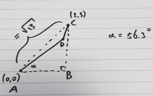

SammyS said:
Do you know the length CD? I see that from the other thread it's length is fixed, but the length AD is not fixed
Yes, CD is fixed and AD is not.
And the length of CD is known
Are the coordinates of points A, B, and C the same as given in your figure, or are those simply for example?
If those are the values to be used, then what is the length CD ?
By the way, there is a relatively straight forward expression for ##\ \tan(\varphi)\ ## in terms of ##\ \sin(\theta) \ ## and ##\ \cos(\theta) \ ## together with the lengths of AB, BC, and CD . This expression does not refer to either of the angles, ##\alpha##, or ##\gamma \,.##
The coordinates are for example as is the length of CD. The goal is to express φ in terms of θ or the other way around. And all the other parameters in the expression have to be known.
