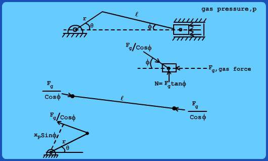

I'm comparing the torque developed by two different engine concepts. One is a new fandangled concept being built that lends itself to a simple torque equation F x r x sine theta (Force, radial vector of the crank, angle of Force) because it has only one angle of Force being applied to the rotating mass. The other is a conventional reciprocating engine with a "square" configuration (equal bore and stroke dimensions). In the conventional engine the above equation works for the crank pin angle (piston rod to crank) but nothing is making sense when I try to combine it with the piston pin angle (piston rod to piston). I know all the angles for any given piston/crank position. I just need the trick to solve for anyone given position... say 90 degrees from TDC. Any mathy engine types available to help me out with this probably elementary problem?

I'm simply trying to determine the torque produced by this mechanism with two angles involved in the "push"... the angle between the vector of the piston and the piston rod (at the piston pin) and then the angle between the radial vector of the crankshaft and the piston rod (at the crank pin).

If I understand you correctly, the following should help you (source):
Where ##x_p = l\cos\phi + r\cos\theta = l(\cos\phi + \frac{r}{l}\cos\theta)## and so the torque is ##T = F_g l(\cos\phi + \frac{r}{l}\cos\theta) \tan\phi## and ##\tan\phi = \frac{\frac{r}{l}\sin\theta}{\sqrt{1-\left(\frac{r}{l}\right)^2 \sin^2\theta}}##​
Now we're talking. There's my two angles. Thank you very much.

What Jack has provided will enable you to compute the torque due to gas pressure, but there is more.
The piston mass is being accelerated, and this requires an internal force. The connecting rod CM is being accelerated (both axially and transversely) and there is an angular acceleration of the connecting rod. All of these mass acceleration terms act like forces (they an not true forces, but M*a terms), so they two contribute to the torque acting on the crank at any particular instant.
To deal with the full problem, it is necessary to have a good handle on the kinematics of the entire system. Then formulating the full equation of motion for a single cylinder, including all accelerating masses, will show what effective torque terms are present.

Thank you very, very much. You confirmed my intuitive fear. I'm over my head. I'll consult with a PhD friend who owes me and let him read these responses.
