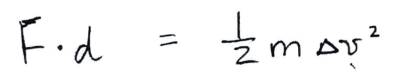

Hello,
For some reason I'm not seeing something in working out a question two ways. The question I'm working through reads:
"A 2500 kg car changes from a velocity of 15 m/s to 25 m/s over a distance of 450 m. What is the work done on the car by the engine?"
I've attached my quandry. I've surmised that the work-energy theorm can be used. Furthermore, that on the work side, I could use kinematics and on the energy side, find the change in kinetic energy. But I don't come up with the same answer on each side? This is mostly because of the difference between (vf^2-vi^2) and (vf-vi)^2. I've attached some handwritten work.
Does anyone see my error?
John

In your handwritten work, you did not calculate the change in kinetic energy correctly.
## KE_f - KE_i \neq \frac 1 2 m (\Delta v)^2##.

Your error is that you wrote the work-energy theorem incorrectly. You have
The right hand side should be the change in kinetic energy ##\Delta K= \frac{1}{2}mv_f^2-\frac{1}{2}mv_i^2##, i.e. subtract the initial KE from the final KE.

Yes, the video is incorrect in the way it solved for ##\Delta v##. The final answer for ##v_f## happened to come out right because ##v_i = 0## in the example.
##\Delta (v^2)## will equal ##(\Delta v)^2## only if ##v_i = 0## or if ##v_f = v_i## (trivial).
Note that ##\frac 1 2 m (\Delta v)^2## is always nonnegative. But we know we can have situations where the KE decreases; that is, ##\Delta KE## is negative.
