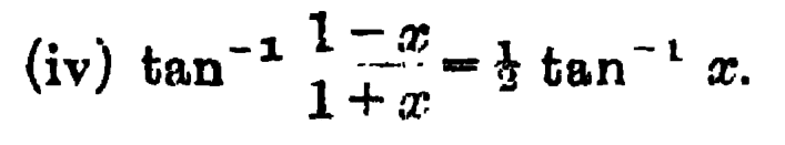

Solve the following equation : ##\pmb{\tan^{-1}\frac{1-x}{1+x}=\frac{1}{2}\tan^{-1}x}##
1. If ##\tan\theta=1\Rightarrow \theta =\tan^{-1} 1 = \tfrac{\pi}{4}##, ##\underline{\text{the principal value}}##.
2. ##\tan(A-B) = \frac{\tan A - \tan B}{1+\tan A \tan B}##
Problem Statement : Solve for ##x## :
Attempt : If I take ##x=\tan\theta##, the L.H.S. reads $$\tan^{-1}\frac{1-\tan\theta}{1+\tan\theta}= \tan^{-1}\left[\tan\left(\frac{\pi}{4}-\theta \right) \right ]=\frac{\pi}{4}-\theta.$$
On going back to ##x## from ##\theta##, the given equation now reads : $$\frac{\pi}{4}-\tan^{-1}x = \frac{1}{2}\tan^{-1}x\Rightarrow \tan^{-1}x=\frac{2}{3}\times \frac{\pi}{4}=\frac{\pi}{6}\Rightarrow \boxed{x=\frac{1}{\sqrt{3}}}.$$
Answer : I copy and paste the answer from the book :
Doubt : Where does the answer ##-\frac{1}{\sqrt{3}}## come from? If we take the principal value of ##\tan^{-1}1=\dfrac{\pi}{4}##, I don't see how there can be a second answer.
A hint or suggestion will be welcome.

Thank you all for your comments. I am the creator (OP) of this thread and I lost most of what you said towards the end. For now I respond to @Mark44 's post #2 :
Mark44 said:
What I would do is to check whether ##-\tfrac{1}{\sqrt{3}}##is a solution of the original equation. If not, the book's answer is a typo.
Problem Statement : Solve the equation :
Attempt : I have solved the problem in my post #1 above. I got the answer ##\boxed{x = \tfrac{1}{\sqrt{3}}}##.
Issue : The text gives the answer : ##\pmb{x = \pm \frac{1}{\sqrt{3}}}##. Where does it get the answer ##x=-\tfrac{1}{\sqrt{3}}## from, when we know that the principal value of ##\tan^{-1}(1) = \tfrac{\pi}{4}##? (see my solutions in post#1 above).
Resolution : Let me put ##x=-\tfrac{1}{\sqrt{3}}## on both sides of the equation to see if the answers match.
L.H.S. = ##\tan^{-1}\frac{1+\frac{1}{\sqrt{3}}}{1-\frac{1}{\sqrt{3}}}= \tan^{-1}\frac{\sqrt{3}+1}{\sqrt{3}-1}=-\tan^{-1}\frac{1+\sqrt{3}}{1-\sqrt{3}}=-\tan^{-1}\left[ \tan\left(\pi/4+\pi/3 \right) \right]=-7\pi/12##.
R.H.S. = ##\frac{1}{2}\tan^{-1}\left(-\frac{1}{\sqrt{3}}\right)=-\frac{1}{2}\tan^{-1}\frac{1}{\sqrt{3}} = -\frac{1}{2}\times\frac{\pi}{6} = -\pi/12.##
Clearly the two sides are different when ##x = -1/\sqrt 3##, unless I am mistaken in my workings above.
That should be enough to rule out ##x = -1/\sqrt 3## as a solution to the given equation.
