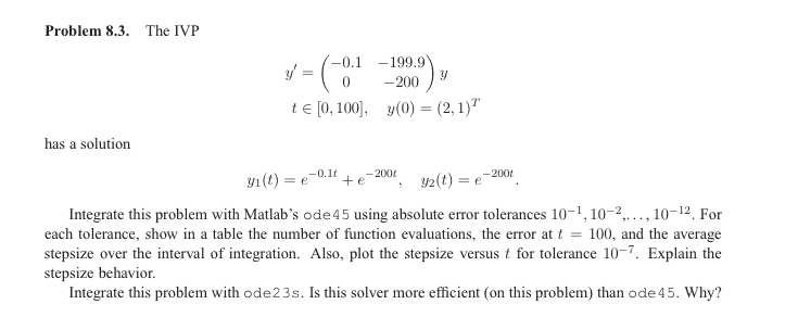

Integration of a problem using Matlab ode45 and matlab ode23, we need to see it for a variety of different error tolerances. The numbers are below, I've included a picture to keep it neater.
Matlab ODE45
My code is as follows: but when I use the function in my command window exactsol(t) and input a tolerance but there is an error in LINE 19 saying unrecognized ivpfun, could someone help me fix it as I am unsure of how to proceed from here.

You haven't defined ivpfun. Read the documentation for examples of how to define a function.
Yes sorry I was looking at that afterwards, I think I'm just struggling with now where to define it. function dydt = ivpfun(t,y) would be my function right? Sorry I am using my professors guide as an example so that's why I am a little confused.
