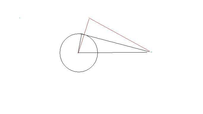

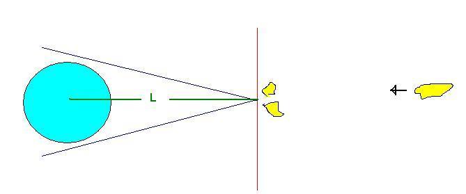

Hello, my teacher gives me a homework/test with the relevant parameters of the movie armageddon. i need some help with the relevant equations and presumptions of that case.
The problem said that a asteroid with 1,45e^6 meters , travels to the Earth to 10 km/s. in this situation, the NASA send a ship to put a nuclear bomb in the asteroid and that this explodes in 2 pieces and turning aside itself next to the Earth. the explotion must be place after that the asteroid goes to the called "zero barrier". four hours after the impact with the earth.
Determines a expresion for L( distance from the center of the Earth to the "zero barrier", in terms of the relevant variables.
-It does not make consideration with respect to the power of a bomb and its influence in sepracion of two parts of asteiorde
-despises the attraction of the sun and the moon on the asteroid
- is relevant the mass of the asteroid? why?
-density of the rock = 3000kg/m^3.
i supossed that the relevant equations are:
P=mv
gravitacion its not include>
Edit:
I suppose that the momentum its conservated and other suposition is that the asteroid goes with velocity to the Earth after the explotion.
if someone helps me would be fine :)

With variable aceleracion. because the force of gravity depends of r. the momentum its not conservative. what can i do when the asteroid its divide in two pieces? about the momentum.
This is an interesting problem. The solutions to it depend on level of math you are expected to know.
The very simplest solution would be to ignore the effects of gravity altogether and figure out the initial velocity in the direction perpendicular to d so as to to just graze the earth.
The second simplest would be maybe have sufficient velocity at a distance R from the Earth's center so that both pieces would just avoid being captured into orbit, in other words: 0.5 m(V^2)/R = -G Mm/R^2 Note m is 1/2 the mass of the original asteroid. Velocity here would just be the resultant of combining the initial 10m/s and the perpendicular velocity caused by splitting the asteroid.
A more accurate solution would be to assume the asteroid parts are on a curved course, but this would assume knowledge of much more than you have stated, and maybe not what is expected. The picture below depicts the first two approaches.
I would try the second approach and see what you get.

Ok, then you know the horizontal velocity is 10m/s and say other velocity = ?
Your drawing shows a right triangle where distance to asteroid is d * cos (a) where a is small angle in triangle. We also know tan (a) = ?/10 m/s.
Can you finish?

D is the distance from the center of the Earth to a distance to the asteroid. right?, but de distante to the barrer zero to the asteroid is dsin(a) , not cos(a). or for the distante d you want mean "L" ?.

4 hours to impact? I don't understand. If it's four hours to impact, isn't L simply (10 km/s)(4 hours), minus the radius of the Earth?
I don't know either--the question is vague. But we know that impact occurs at the surface of the earth, so d must be:
4 hr* 3600 sec/hr *10,000 m/s + R which is the radius of the earth.
We also need to deflect the asteroid by a distance not quite R in the 4 hours . That distance is L sin (theta), and again tan (theta) would be Vy/Vx = Vy/10 Km/s.
Unless gravity is called in or we are given more information the problem, that's about all I can see to do-- you should solve for Vy. Beyond that, ??

You are right. I am assuming something very unlikely--that a nuclear bomb can be made like a shaped charge so that only the vertical velocity is changed. But maybe it is a long and thin asteroid and can be "cut" into two. In one of your posts you suggest that the momentum is conserved. This is true. The parts may split along an axis at that is not perpendicular to L. In one case, the horizontal velocity will be increased, while the other half will be slowed. I haven't seen the movie, but just now read a bit about the best driller on Earth and his crew are the team recruited, so if a nuclear explosion can be shaped, I'm assuming these guys can do it like your diagram shows.
