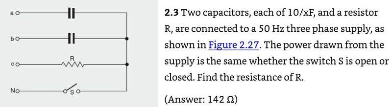

Solving Current & Power in 4 & 3 Wire Circuits
In summary: In the end I ran into something of a cul-de-sac where my expression for R was a quadratic with complex roots, so I must have gone awry somewhere. I'll check my workings before posting again to see if I can spot any mistakes....just a quick question, did you get exactly the same or equivalent expressions for current as I did, or were there any slight differences?
Evari5te
Two capacitors each of "10/xF" and a resistor are connected to a 50 Hz three phase power supply, as shown in figure 2.27. The power drawn from the supply is the same whether the switch S is open or closed. Find the resistance of R. - See attached file for diagram and original statement
Complex Power S = VI*
I assume that the "power drawn" refers to the active power, which I understand as being the real part of S in either scenario.
For power to be the same regardless of switch S being closed (four wire) or open (three wire)
Four wire power = three wire power
=>Re{VcnIc*} = Re{ [Vcn-Vnn’]Ic*}
Where Vcn is the c line to neutral voltage of the supply, Ic is the c line current and Vnn’ is the voltage of the load floating neutral with respect to ground in the three wire scenario.
Vnn’ is determined by Millman’s equation Vnn' = VanYa + VbnYb + VcnYc / (Ya + Yb + Yc)
where voltages are phase to neutral of the supply and Y values the admittances (reciprocal of impedance)
Ya = Yb = jωC = j2πfC
Yc = 1/R
My thoughts were I could use mesh current analysis to derive equations for current hence power in each case in terms of ωC and R, set the equations for real power equal to each other and solve for R. While ωC are known I opted to leave them as letters thinking this might make life easier when reducing the equations.
I assumed "10/xF" is actually 10 micro Farads - I have the Kindle version and am guessing that /x is a printing error because an unusual character, most likely μ, has been kicked out, n and p being the only other common prefixes.
I took Vab as the reference phasor and V(line) is 1 Volt. The actual voltage is irrelevant to the question

How much current do you expect to flow through the switch when closed?
In = Ia + Ib + Ic from the above equations this is the mesh current I3.

Only the resistor consumes power. The power delivered for the two cases will be the same if the current amplitude through the resistor, ##|I_c|##, is the same for the two cases. Your results for the two cases are
$$I_c = \frac{j}{\sqrt 3 R} \,\,\,\, \rm{switch \,\, closed}$$ $$I_c = \frac{-\sqrt{3} \omega C}{1+j2\omega C R} \,\,\,\, \rm{switch \,\, open}$$
What do you get for ##R## by requiring ##|I_c|## to be the same for the two cases?

Finally had a bit of time to circle back to this problem and indeed I had gone some way adrift.
Thanks to TSny both for the steer and for using LaTex, which once I learnt to use it helped me with setting out my workings much more clearly and spotting the mistakes.
Also for the common sense learning points - I did not need to use current mesh analysis for the four wire scenario, it should have been obvious that with the zero impedance link connecting load and supply common points to earth the voltage across the resistor, ##\mathbf{V_R}## is the same as the phase c supply voltage ##\mathbf{V_{cn}}##.
It then follows from basic circuit theory with just a single resistor on phase c that ##I_c = \frac{V_{cn}}{R}## directly giving the expression for current,
##I^{S closed}_c = \frac{j}{\sqrt{3}R}##.
where ##\mathbf{V_{ab}}## is chosen as the reference phasor, so no need to solve three simulataneous equations that only served to show this fact.
Similarly in the three wire scenario it was only necessary to solve two simultaneous equations from the mesh current analysis to determine an expression for ##I^{S open}_c##.
The voltage across the resistor is - apart from not being relevant to the question once current is determined - given by basic circuit theory ##V_R = I^{S open}_c.R## so thinking I would need to use Macmillans formula to determine voltage of floating neutral ##V_{nn'}## was all an unnecessary distraction.
All this to say I was getting a bit too hung up on irrelevant - and in the end way too complicated formulas - to resolve, and TSny's insight that magnitude of phase c current was only thing needed to equate across both scenarios without fully working out power was really helpful.
Final workings to get the right answer shown below:
##I^{S closed}_c = \frac {j}{\sqrt{3}.R}## and ##I^{S open}_c = -\frac{\sqrt{3}ωC}{(1 + j2ωCR)}##
and for power to be the same in both scenarios, ##|I^{S closed}_c| = |I^{S open}_c|##
##I^{S closed}_c## is a vertical phasor with entirely imaginary component therefore
##|I^{S closed}_c| = \frac{1}{\sqrt{3}.R}##
##I^{S open}_c## is the product of ## -\sqrt{3}ωC.\frac{1}{(1 + j2ωCR)}##
therefore
##|I^{S open}_c| = \sqrt{3}ωC.\frac{1}{|1 + j2ωCR|} = \sqrt{3}ωC.\frac{1}{\sqrt{1^2 + 2^2ω^2C^2R^2}} = \sqrt{3}ωC.\frac{1}{\sqrt{1 + 4ω^2C^2R^2}}##
##|I^{S closed}_c| = |I^{S open}_c|####\frac{1}{\sqrt{3}.R} = \sqrt{3}ωC.\frac{1}{\sqrt{1 + 4ω^2C^2R^2}}##
##\sqrt{3}.R = \frac{\sqrt{1 + 4ω^2C^2R^2}}{\sqrt{3}ωC}##
##3ωCR = \sqrt{1 + 4ω^2C^2R^2}##
##9ω^2C^2R^2 = 1 + 4ω^2C^2R^2##
##9ω^2C^2R^2 - 4ω^2C^2R^2 = 1##
##5ω^2C^2R^2 = 1##
##R^2 = \frac{1}{5ω^2C^2}##
##R= \sqrt{\frac{1}{5ω^2C^2}} = \frac{1}{\sqrt{5}ωC}##
where ##\omega = 2\pi f = 100\pi##, for a 50Hz supply and ##C = 10\mu f = 10^{-5} f##
##R = \frac{1}{\sqrt{5}.100\pi (10^{-5}) } = 142 \Omega##

That looks good.
