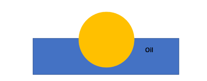

A solid gold ball is floated on an oil bath so that half the ball is above the oil and the other half is immersed in oil. The oil has a relative permittivity of εr. Charge Q is released on the ball. Calculate the electric field in space. What is the charge density on the ball for the part above the oil and in the oil.
surface integral D * dS = Q_free
D = E * epsilon_o
a) Find the electric field in space
For r < R (where R is the radius of the gold ball), E = 0 because the gold ball is a conductor.
For r > R, let us make a Gaussian surface. $$\int \vec{D} \cdot \vec{dS} = Q_{free} \implies \vec{D} = \frac{Q}{4 \pi r^2}$$
Now this is a bit hand wavy but the two dielectrics (air and oil) appear to be in "parallel" so we can just add them together as such $$\epsilon _{total} = \epsilon_o + \epsilon_o \epsilon_r $$
$$\implies \vec{E} = \frac{Q}{4 \pi r^2 \epsilon_o (1 + \epsilon_r)}$$
The problem is the answer is $$ \vec{E} = \frac{Q}{2 \pi r^2 \epsilon_o (1 + \epsilon_r)}$$ where is this factor of 1/2 coming from? b) As for charge density, I'm not sure how to calculate this. The answers are though $$Top side: \rho_s = \frac{Q}{2 \pi (1 + \epsilon_r) R^2}$$ $$Bottom side: \rho_s = \frac{\epsilon_r Q}{2 \pi (1 + \epsilon_r) R^2}$$
Any help would be appreciated
So if it were air above and below you would use 2ε0?
Btw, this must be very dense oil.

Question to yourself: What is the relative charge distribution above and below the oil-air interface?
Hint: compute the potential of the ball as integrated E field in two paths: in air and thru oil. Remember the potential of the ball is the same thruout the ball. What does that tell you about the two E fields integrated to infinity?
Then, what needs to happen at the oil-air interface to satisfy this requirement?
Note that your answer for the charge densities could not be correct since total charge must = Q.
