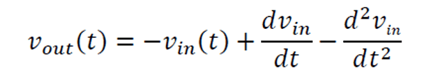

Design a circuit that satisfies this differential equation using op-amps, resistors, and capacitors.
v_{out} = -RC \dfrac{dv_{in}}{dt}
where: 𝑣𝑖𝑛(𝑡)=0.3𝑐𝑜𝑠100𝑡
I have read all over the internet that this differential equation can be solved by isolating the term with the highest degree on one side of the equation. After doing so, I integrated it. However after integrating, I don't know that the next step is. Can anyone help me understand the concept on designing circuits with this differential equation? Specifically the concepts of integrator, summer, and differentiator operational amplifiers. Have tried to understand example on linear circuit analysis but their steps were way of a shortcut, making it hard for me to grasp the concept. A help from you guys will be really appreciated.

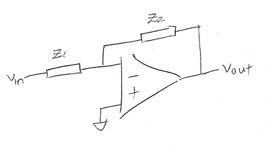

Do you recall the transfer function for this op-amp? Your professor might tell you to use KCL to solve for it, but if you're having a hard time then it's a classic (inverter) you'll typically see with resistors; however: What does its transfer function look like if you replace ##Z_1## and ##Z_2## with one resistor and one capacitor (in the frequency domain)? Try it like this:
One like this:
$$\begin{align} Z_1 = R \nonumber \\ Z_2 = C \nonumber\end{align}$$
The other like this (swap ##C## and ##R##):
$$\begin{align} Z_1 = C \nonumber \\ Z_2 = R \nonumber \end{align}$$

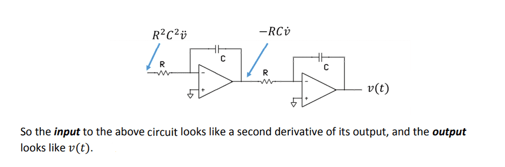

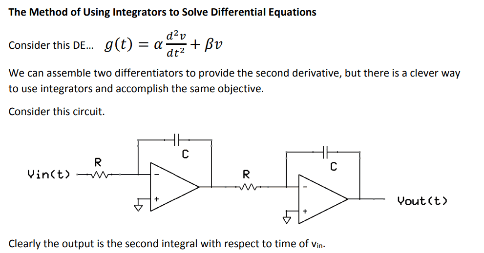

Here is a sample explanation on the differential equation. However, I can't even guess what is happening right here. Why is there a need to feed the input voltage to an integrator?
I can completely understand the confusion. I feel confused reading it too. I think that text is trying to say more specifically how you can achieve the second derivative in two different ways (forward with differentiators or backwards with integrators).

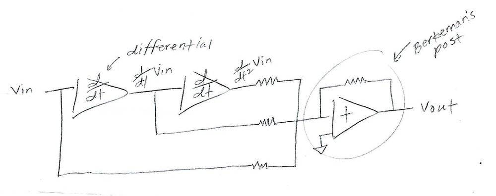

I was imagining 3 op-amps too. I'm not sure if what I'm about to share is close to what berkeman had in mind, but here is what I had in mind. After a couple more thoughts you might need an inverting op-amp because the signs change so not all of them are addition neither are all of them subtraction. I think you'll have to explore that on your own so that we don't deprive you of the learning experience, which is also why I've made it very simplified not including the op-amp configuration/details and most passives.
Do you think you could work with this? This is probably really pushing it.
Likes Delta2 and HansBu
Those circuits are using integrators. To implement your equation that you posted, you need differentiators. Try swapping the positions of the R and C components in the first 2-opamp circuits that you posted and calculate ##\frac{V_{out}}{V_{in}}## for the two opamp outputs with respect to the input to the first opamp. Then look at the summing opamp circuit that I posted above, and well, you know... :wink:
