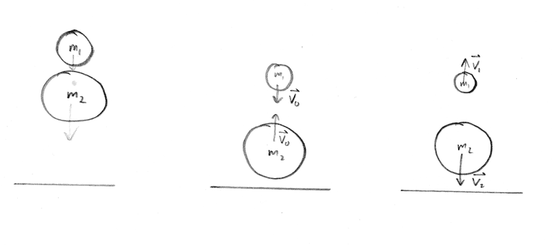

Two elastic balls of masses m1 and m2 are placed one above the other (leaving a very small gap between them) and
are released to fall freely on a height from a height h. Assuming that the impact on the floor is elastic, calculate:
a. what must be the ratio m1/m2 of the balls so that the top ball gets the biggest part of total balls energy after impact?
b. What is the maximum height a ball of mass m1 can rise after impact?
h is much bigger than dimension the of balls.
Conservation of energy and momentum.

Hello, @mmfiizik ,
:welcome:
Below we have your image at full size.
The middle figure shows that you are aware that the bottom ball, Ball 2, rebounds (what @haruspex calls the first collision) from the floor with velocity ##v_0##.
Assuming upwards to be positive, the balls then collide with the the initial velocity of Ball 1 being ##-v_0## and the initial velocity of Ball 2 being ##v_0##, where ##v_0=\sqrt{2gh}##.

Thank you @SammyS for drawing my attention to the diagrams.

So then (2) should be
$$m_{2}{v}_{0}-m_{1}{v}_{0}=m_{2}{v}_{2}+m_{1}{v}_{1}$$
then I get ##2v_0=v_1-v_2##, which gives me same result if I square it. I think somehow I should find maximum velocity for ##m_1## after first collision with ##m_2##. Then it would get maximum kinetic energy.

It would be less confusing to change your convention for ##v_2## to be positive up. Then $$m_{2}{v}_{0}-m_{1}{v}_{0}=m_{2}{v}_{2}+m_{1}{v}_{1} $$
and generically for perfectly elastic collisions ##u_1-u_2=u_2'-u_1'##, where in the present case ##u_1=-v_0, u_2=v_0, u_1'=v_1, u_2'=v_2##.

Ok, so then ##-2v_0=v_2-v_1##
replacing ##v_1## in (2)
$$m_{2}{v}_{0}=m_{2}{v}_{2}+m_{1}{v}_{2}+3m_{1}{v}_{0} $$
$${v}_{2}=\frac{v_{0}(m_{2}-3m_{1})}{m_{1}+m_{2}}$$
Energy converted = first ball energy / total energy
$$E=\frac{m_{2}v_{2}^{2}}{m_{1}v_{0}^{2}+m_{2}v_{0}^{2}}$$
$$E=\frac{m_{2}^{2}+9m_{1}^{2}-6m_{1}m_{2}}{m_{2}^{2}+m_{1}^{2}+2m_{1}m_{2}}\\$$
Let ##k=m1/m2##
$$E=\frac{(1-3k)^2}{(1+k)^2}$$
Maximum energy which first ball gets is at:
$$k=\frac{1}{3}$$
Is it right?
You appear to have minimised the energy of ##m_2##, without saying so?
PS I think it should be ##(1+k)^3## on the denominator.
Likes MatinSAR
PPS if you look carefully, there is a massive short cut for this question!

No.
First, a zero derivative only implies a local extremum. It is not necessarily a local maximum, and even if it is that, not necessarily the absolute maximum.
What do you get for ##v_2## if you plug in k=1/3?
Secondly, you are not asked for the maximum of ##v_2## anyway. You are only asked for conditions on the mass ratio such that ##m_2## gets the lion's share of the energy.
And as @PeroK noted, the denominator should be ##(1+k)^3##.

Yes, I made some mistakes in previous solution.
Expression for energy gain should be written for the first ball, not the second.
$$E=\frac{m_{1}v_{1}^{2}}{m_{1}v_{0}^{2}+m_{2}v_{0}^{2}}$$
solving ##v_1## from (2)
$$v_{1}=\frac{v_{0}(3m_{2}-_{}m_{1})}{m_{1}+m_{2}}$$
replacing ##v_1^2## gives:
$$E=\frac{k(3-k)^{2}}{(k+1)^3}$$

I don't know how should I prove it for the absolute maximum.
I believe that should imply that maximum energy loss for ##m_1## is when ##m_1=3m_2##, because it just stops ##(v_1=0)## and so all kinetic energy is transferred to ##m_2##.
And minimum energy loss for ##m_1## is when ##3m_1=m_2##, because then ##m_2## ball stops and first ball gets all of the kinetic energy from the second ball. I think I should not take into account potential energy, because gap between them is very small and before collision they are almost on the ground.

You do not seem to have understood this comment:
haruspex said:
you are not asked for the maximum of v2 anyway. You are only asked for conditions on the mass ratio such that m2 gets the lion's share of the energy
You are still thinking in terms of maximising ##m_2##'s energy, which is not the task.
You are to find those values of the ratio (a range or ranges) such that it has more KE than ##m_1## does after their collision.

Actually, the top ball is the ball with mass, ##m_1##.
Likes haruspex, mmfiizik and hutchphd

But in the task there is written biggest part of energy, not bigger. So there is only one ratio of masses with which ##m_1##'s KE is biggest, right? And I have to maximize for ##m_1## energy, because it's the top one.
True, it is ambiguous. One way or another it is grammatically inconsistent. Should say either "bigger part" or "biggest amount".
Taking the biggest amount view…
Yes, that is the best approach.
