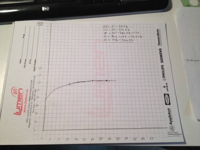

Hello,
Okay, I have finally worked out a decent curve to work with which is in accordance with my previous post called "How to create a simple mathematical model".
According to the attachment in this thread, I have deemed the following equation format as respective to the curve in my attachment.
f(x) = x^ -ax + b
I could be wrong about this... but it's what I think... please let me know if I am incorrect in my assumption.
I have selected one coordinate in the curve which is (30, 124) and I would like to complete the equation above using this coordinate.
So I tried:
f(x) = x^ -ax + b
124 = 30^ - 30a + b
0 = 900 - 124 - 30a + b
0 = 776 - 30a + b
I don't quite remember how to solve for a and b. Can someone please show me how to solve this equation which has two unknowns!
All help or tutorial links is appreciated!
thanks

hi jedishrfu,
I have a proximity sensor that detects 0-240" based on 0-135 steps of infra red light emitted by an LED. For my led, I have a current source that can go from 0 ma to approximately 40 ma. I can increment my current source in 135 steps. Therefore, when my current source is at 0 steps, I have 0 ma through the led and therefore the detector has a maximum detection range of 0".
Every step I increment my current source, the current through the led increments exponentially from 0 ma to 40 ma. The relation in steps vs inches is the graph I plotted by doing measurements myself.
So, as shown in the graphic curve, the coordinates are selected by the following observations:
at 101 steps of current, there is enough infra red light generated from the led for the sensor to detect something at 6"...
at 114 steps of current, there is enough infra red light generated from the led for the sensor to detect something at 14"...
at 120 steps of current, there is enough infra red light generated from the led for the sensor to detect something at 22"...
at 124 steps of current, there is enough infra red light generated from the led for the sensor to detect something at 30"...
at 126 steps of current, there is enough infra red light generated from the led for the sensor to detect something at 38"...
hence coordinates:
(6, 101)
(14, 114)
(22, 120)
(30, 124)
(38, 126)
Now, I will know perhaps two points as I did in my attempt to calculate the equation above! But from those two points, I may need to know how many need to know how many steps are required for odd distances such as, 7" or 18" or 24" etc...
So based on one equation, I would like to use it to figure out the distance in inches related to any step value I want!
And I am having trouble finding that equation for this particular curve!
This curve seems like a parabola no? Its a wide parabola, but nonetheless a parabola!
As you may have noted, I only need the left half of this parabola for my values plotted!
