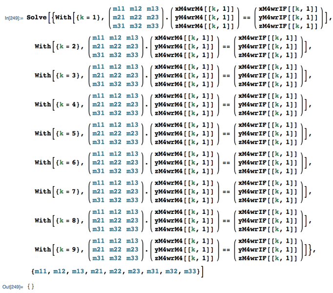

I'm trying to reconstruct the matrix M with Mathematica's Solve[ ]:

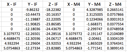

The vectors are basically (x, y ,z) and (x' , y' , z') coordinates
And the data behind this mess is here - shown in (x,y,z) row sets - where the "M4" and "IF" would be like A and B in M*A = B. The data looks linearly independent:
So, I don't know why I'm getting those empty brackets in Mathematica. Maybe I should explicitly write each equation, but I'm assuming Mathematica can handle that.

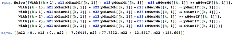

I managed to find a number of the elements by rewriting my Solve[ ] call:
And, as you can see above, I'm left with the first column vector within M, i.e. [m11; m21; m31], left to be determined.
To be honest, I don't understand why I have those 3 elements left to be determined. Using vector rows beyond row 2 (i.e. k > 2) are giving open brackets solutions.

You are using too many vectors and so they are not linearly independent. Since you have numerical values you are likely getting rounding errors, making the system undetermined. Since you have only used vectors with x value zero, you are getting an undetermined first column.
You need to use three linearly independent vectors.
