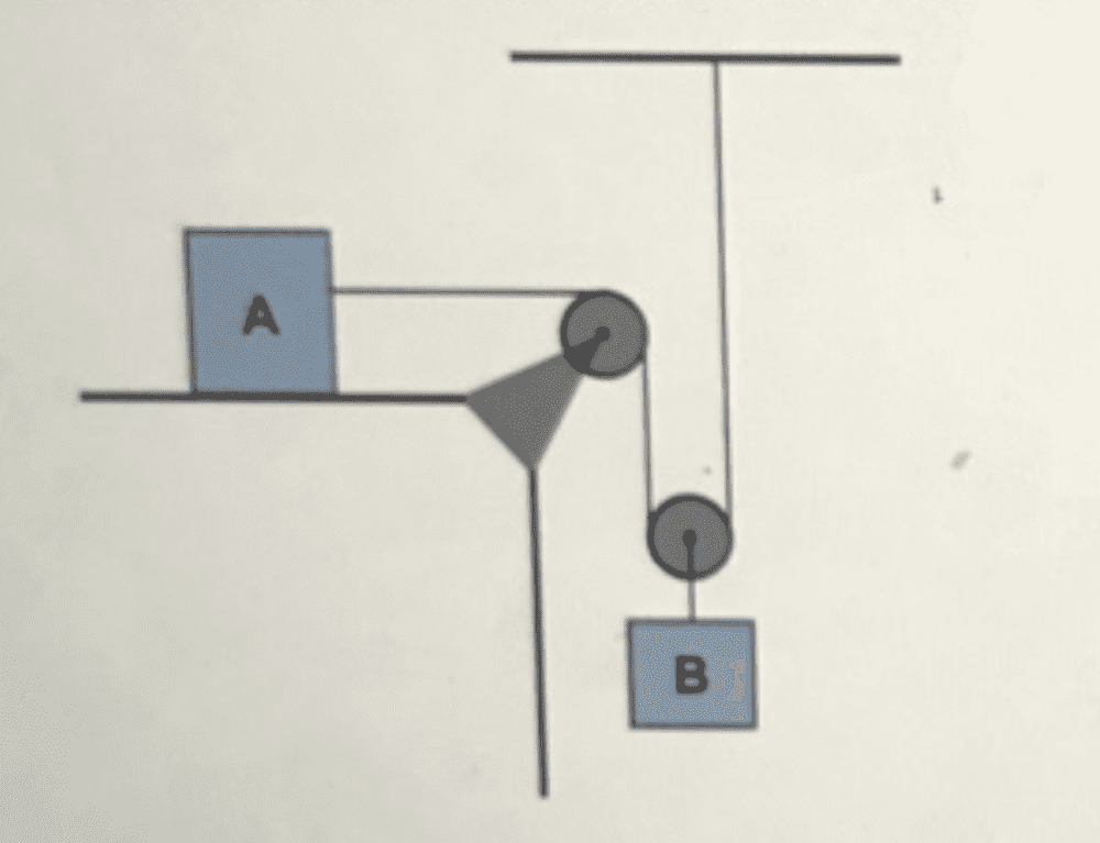

If block A has mass M and block b has mass m, find the acceleration of block B assuming that the acceleration of block A equals two times the acceleration of block B.
Equation 1: T = Ma1
Equation 2: mg - 2T = ma2
Equation 3: a1 = 2a2
241179
Equation 1: T = Ma1
Since a1 = 2a for equation one I get T = 2Ma1
mg - 4Ma1 = ma1
mg = 4Ma1 + ma1
mg = 4a1(M+m)
a1= mg / 4M+m
Not sure if this is correct. Can someone please help to make sure I'm doing this right?
Thanx
Looks correct, I got same answer,
##a_{\rm B}=\frac{mg}{m+4M} ##
