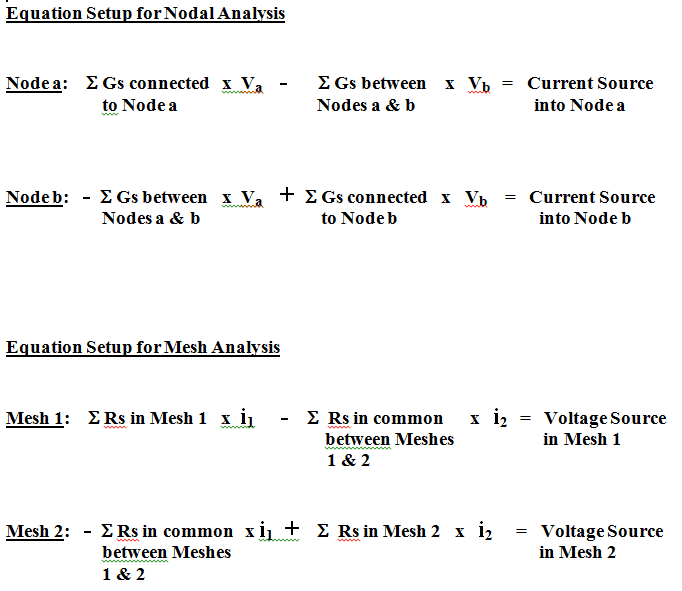

Assume that I = 22mA , V = 6.0V , and R = 350Ω. Determine the current between B and D using the superposition principle.
V=IR
Superposition Principle
G=1/R
Voltage and Current dividers
I think I'm understanding the superposition just fine, but having issues when actually solving for the current.
I_BD = I_BD' + I_BD''
Replacing the current source with an open circuit, I used mesh analysis to find I_BD'. With the current source removed, there were 2 meshes left in the circuit:
Mesh 1 (on the left):
400*i_1 - 300*i_2 = 6
Mesh 2 (on the right):
1050*i_2 - 300*i_1 = 0
i_1 = 0.019, i_2 = 0.0055
Using the voltage divider principle, v=6*(100/1050)=0.57.
V=IR, I_BD'=V/R=0.57/100=0.0057
Now removing the voltage source and replacing it with a short circuit, I used nodal analysis to solve for the voltages at each node, then used (v_d-v_b)/100 = I_BD''. The node between node A and node C will be addressed as node E.
Node A:
(1/100+1/350+1/300)*v_A - (1/100+1/300)*v_B - v_E/350 = 0
Node B:
-(1/100+1/350)*v_A + (1/100+1/300+1/100)*v_B - v_D/100 = 0
Node C:
(1/200+1/100)*v_C - v_D/100 - v_3/200 = 0
Node D:
-v_B/100 - v_C/100 + (1/100+1/100)*v_D = -0.022
Node E:
-v_A/350 - v_C/200 + (1/350+1/200)*v_E = 0.022
Solving, I got: v_A=0, v_B=-0.6, v_C=0, v_D=-1.4, v_E=28.I_BD'' = (v_d-v_b)/100 = -0.008

I understand what you're saying, and it does seem like a much simpler approach than what I had come up with. However, I'm still not getting the correct answer. I believe I solved the part where the voltage source is shorted correctly:
100*300/(100+300) = 75. Applying the current divider, I got:
I_BD'' = -0.022 * 300/825 = -0.008, which is what I got using my method.
Now when solving with the current source removed, I simplified the resistors to get an equivalent resistance of 750 Ohms. I then combined the 300 and 750 Ohm resistors in parallel, then combined that equivalent with the 100 Ohm resistor to get a total resistance of 314.3 Ohms. Solving with V=IR, I got I_total = 0.019 A. However, this is the part where I'm not entirely understanding what you're saying. I tried applying the current divider on the following circuit:
I_BD' = 0.019 * 300/1050 = 0.0054 A
Combining the two currents, I_BD = -0.0026 A which is incorrect. However, I now received the following feedback:
"Not quite. Check through your calculations; you may have made a rounding error or used the wrong number of significant figures."
I like what you did.. maybe not round the equivalent resistance as much? take 314.25 instead of 314.3
What you are doing is how I would do it as well so I am not sure why it is not right. Maybe someone else could weigh in
