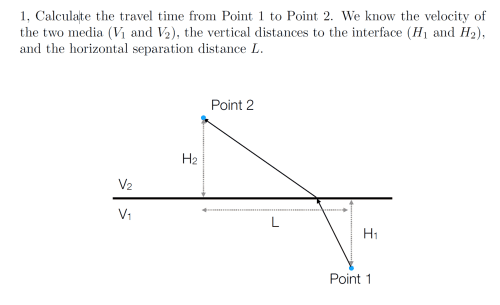

Calculate the travel time from Point 1 to Point 2. We know the velocity of
the two media (V1 and V2), the vertical distances to the interface (H1 and H2),
and the horizontal separation distance L.

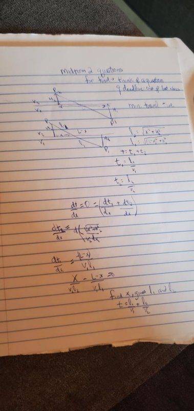

u1sin1 = u2sin2, (x/(v2l2)) - ((L-x)/(v1l1)) = 0, t = (l1/v1) + (l2/v2)
I was told to solve the second equation above for x to get l2 and l2, but that only gets me those in terms of other unknowns. I'm assuming I just need to solve t for my knowns, but I keep getting caught up by my unknowns. i.e., solving for x gives x = (l2*L*v2)/(l1*v1+l2*v2). Please note "l" is a lowercase L. The lowercase denotes the length of the respective hypotenuses while the capital L denotes horizontal separation distance.
I know Snell's law is important here, but I'm not really sure how it helps me.

I presume u1 is the same as v1, etc., and sin1 should be sin(θ1), etc.
What is the relationship between θ1, x, L and H1?
