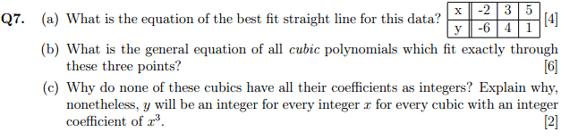

For Part A) I did the normal best fit straight line stuff, A^τAX=bA^τ etc, resulting in:
y= 31/26x -8/3
Now part B) is where I need a hand, I started with just cubing, squaring etc the terms given and doing row ops, which is where I'm at now. It just seems like it's getting too ugly and I'm not sure where I'm going with it.
